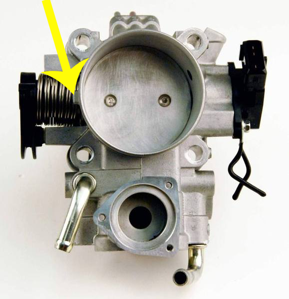

If you hear hissing from the TB, there is a seal that will leak if damaged. I would start there. I had one leaking in my old evo 8 that i had to replace.

When I started doing leak testing on my Evo 8 the main things I had to replace was the seals around the throttle body shaft and my injector top/bottom seals. When doing a boost leak test, move the throttle open/closed by hand, wiggle it and press in a few directions. If you find any leaking around it, I would replace the seals. This is a very common seal that leaks. There is a video out there that shows replacing them. Be careful when inserting them as the metal can deform.
