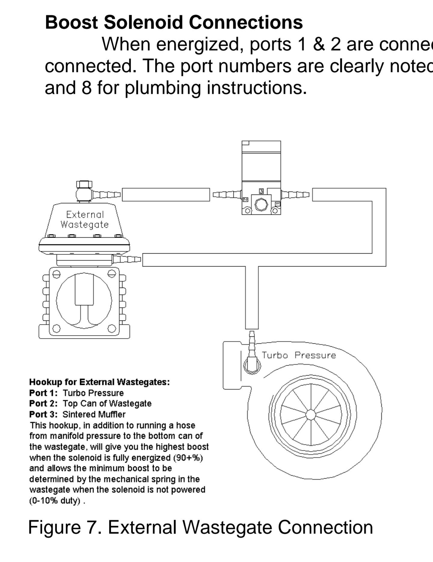

I upgraded to a FP black with Tial external waste gate and Mac solenoid. My question is on the WG. Ive read conflicting things. One says to run from the solenoid to the bottom port of the wg leaving the top completely open. The other way says to a hose from the turbo to the bottom port and a hose from the solenoid to the top port. Im running 21.75 lbs of springs and aiming for upper 600s. Can anyone help me, im lost

Here's a picture taken from the AEM boost solenoid instructions, which uses the MAC solenoid.

Thank you so much. It's hard to get a solid question on this
