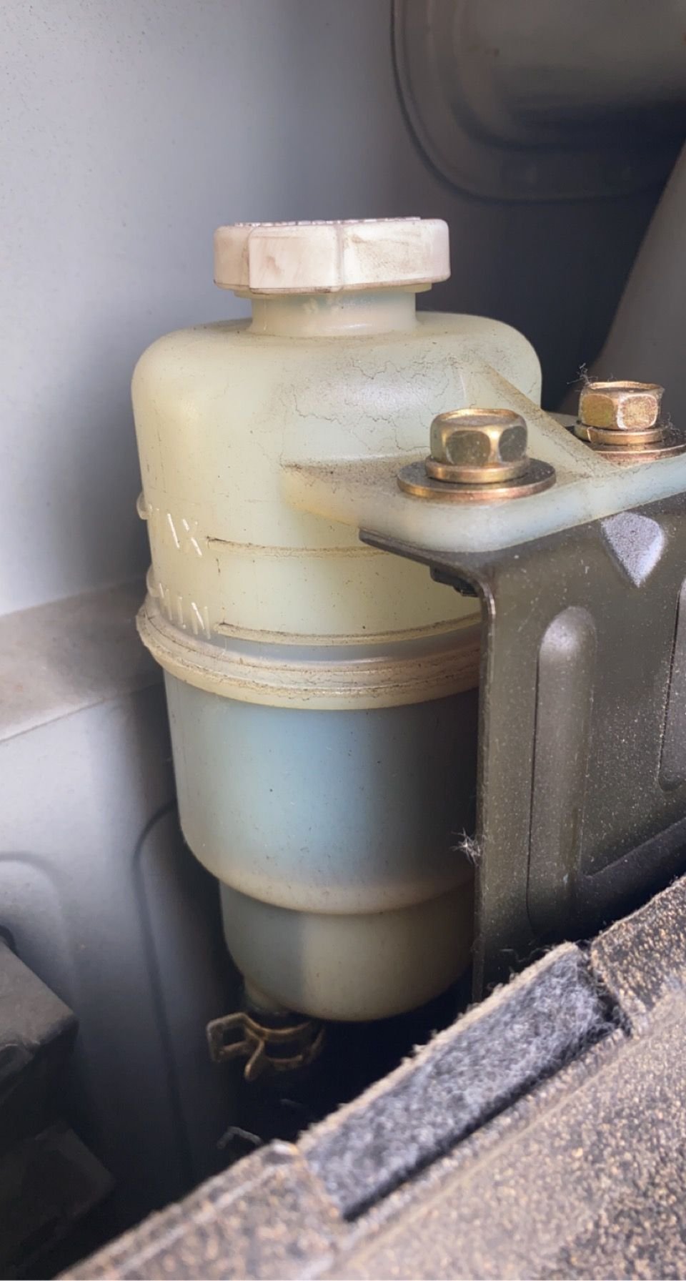

Is that the AYC fluid? Seems to be low would this be causing the 3 lights to come on ? What fluid do i need to put into this ? Thanks for all your help
Yes - the ACD (Active Center Diff - inside the transfer case) and AYC (Active Yaw Control - inside the rear diff) are both fed from the pump below this reservoir. Make sure you top it up while bleeding the ACD line.
Use any quality Automatic Transmission Fluid rated SP-III or higher.
