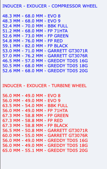

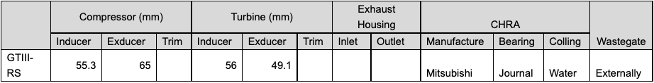

Got this information from HKS after emailing them. So confirmed the GTIII is journal bearing. I then compared it to the OEM IX turbo:
https://www.evolutionm.net/forums/ev...ence-only.html
