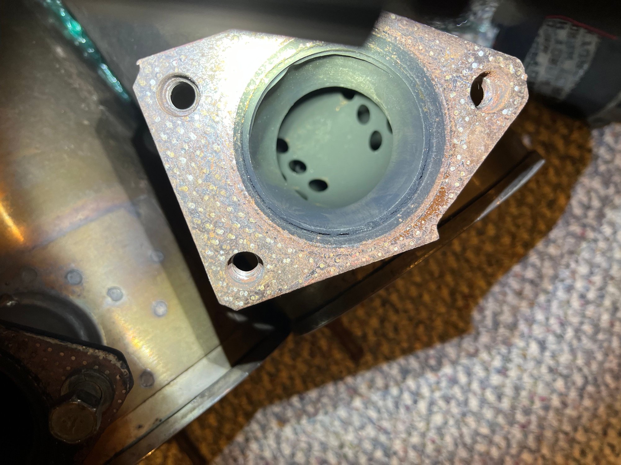

Anyone know whether the stock Evo8 or Evo9 muffler flows better than the other? I've given up on running an aftermarket muffler for street driving. My car is just loud with anything but a stock muffler due to cams, turbo, etc., and the law here in Virginia prohibits any non-stock exhaust that sounds "unusual" or "excessive."
The Evo8 and Evo9 mufflers have different designs internally. The Evo8 has a spring-loaded small round trap door to divert exhaust through the chambered portion and the Evo9 muffler has a perforated divider with holes in it that limits the amount of flow around the chambered section. Not sure why Mitsu changed the design or which is less restrictive under boost. Any of the OGs here have any idea or remember?

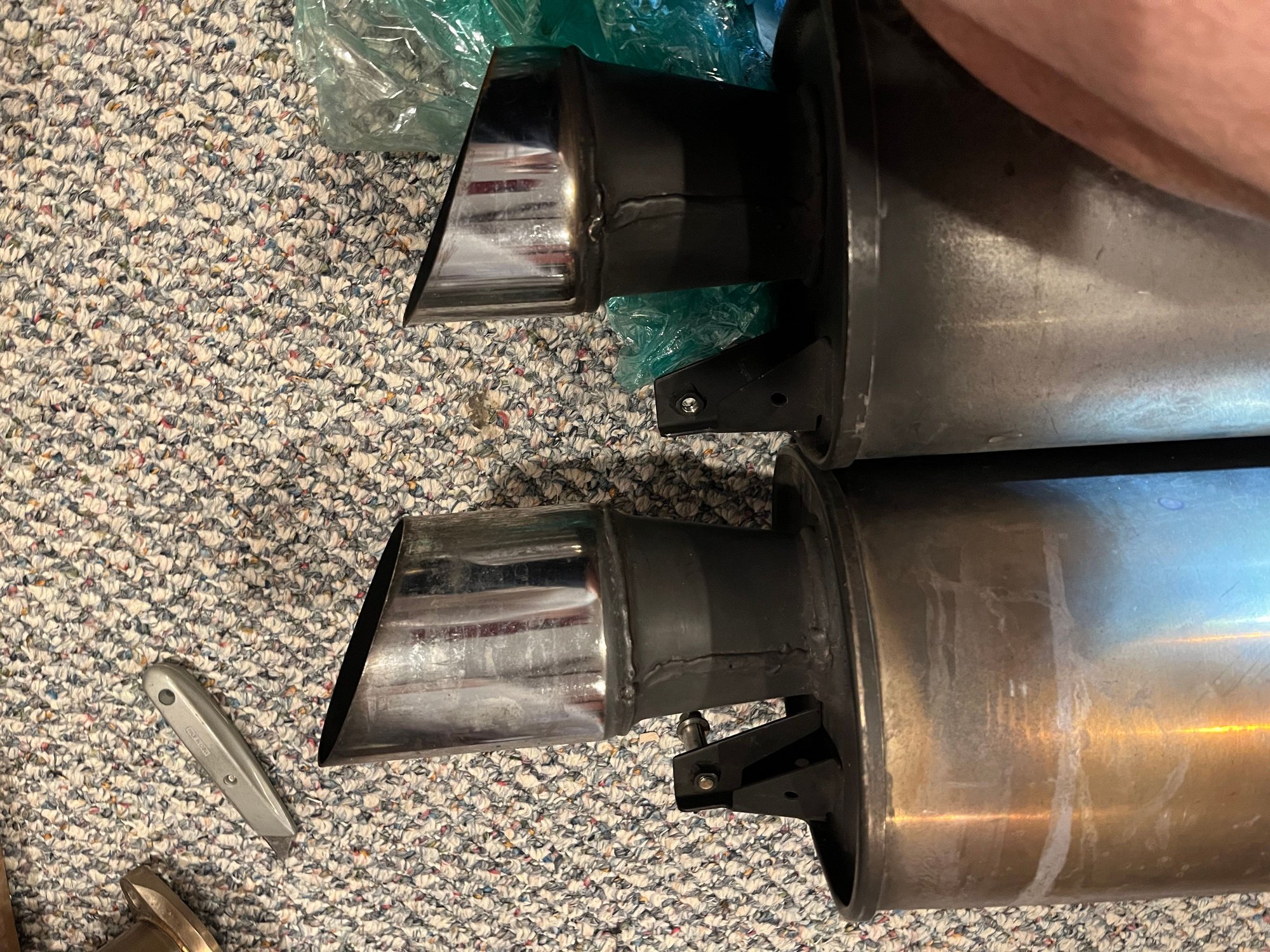

Here are the muffler differences between Evo8 and Evo9. Not sure if my Evo9 muffler was cut by a previous owner for a JDM bumper or if they are all short like that?

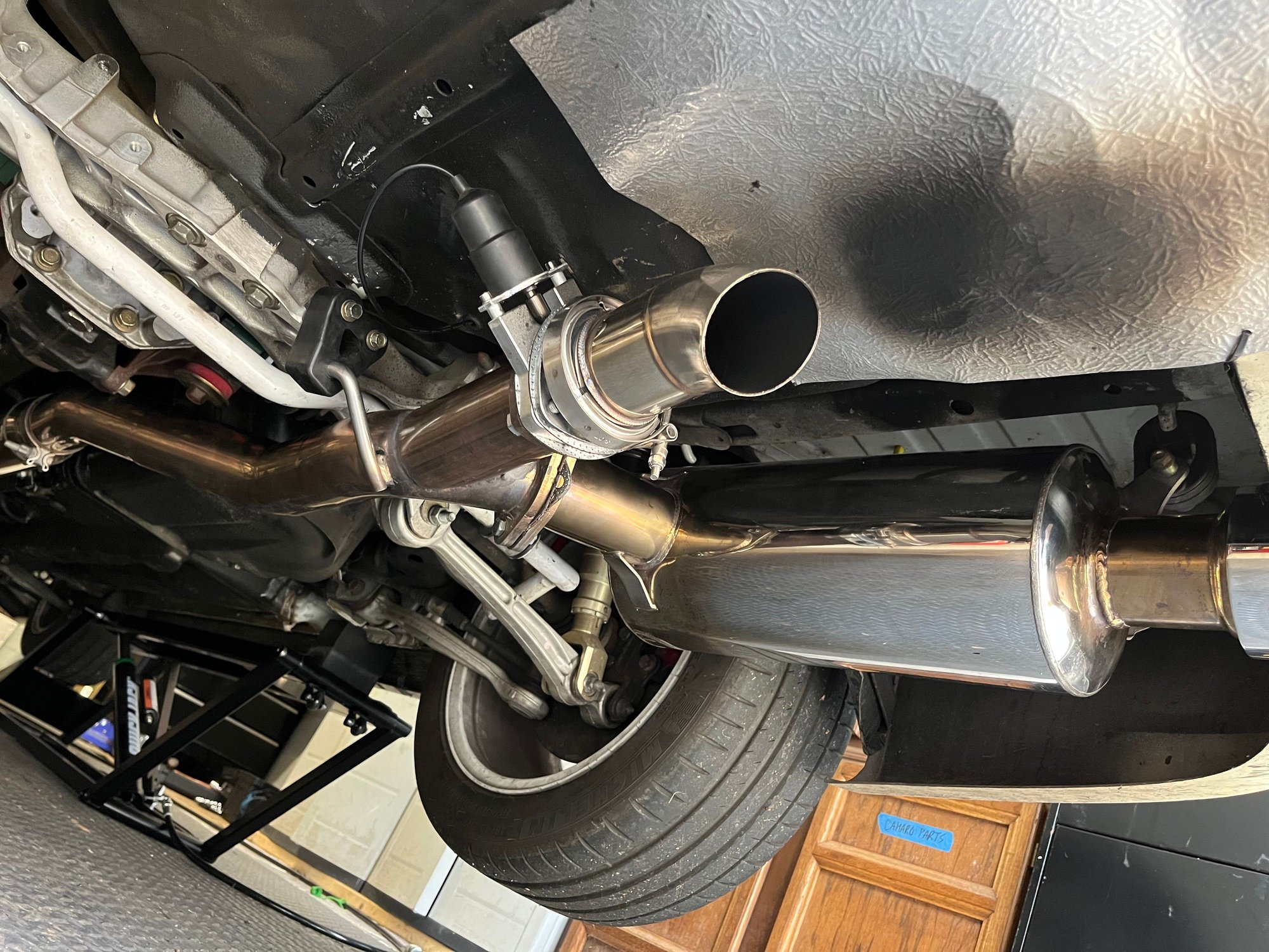

From: Northern Virginia
I really want to have full 3” flow when I’m at the track or autocross and noise isn’t a factor.. I have a cur-out before the muffler and, if I swap in my Works AB (which is kind of loud on the street, but a direct bolt-in replacement for the stock muffler), then I have a full muffled 3” system after some work in the garage. I’ve tried a number of catbacks but keep coming back to this setup. I’ve thought about the Varex, but it seems to be extremely restrictive when closed from what I’ve read and can develop rattles and valve sticking issues over time. The stock muffler isn’t great, but it’s way better flowing than a silencer or a tiny bypass hole in a valved muffler. I’m going to save that Evo9 muffler in case I switch rear bumpers some day.

They cut it. The Evo 8/9 mufflers were actually the correct length for JDM rear and too short for USDM rear really. IIRC the 9 muffler is slightly better sounding.
