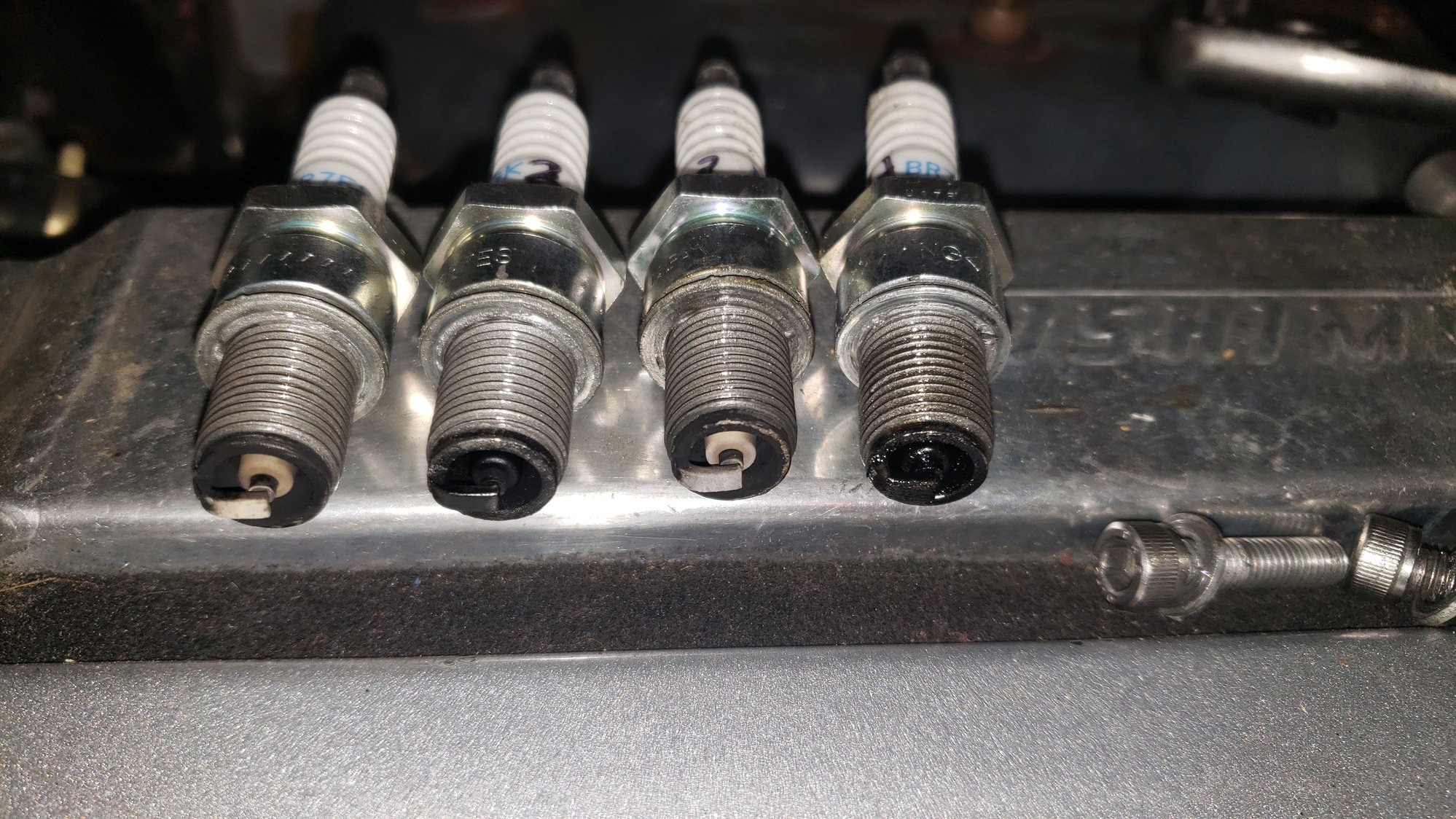

When I first pulled the number 4...
2 is kinda dark but wasn't wet looking.
They're NGK copper BR7es I think

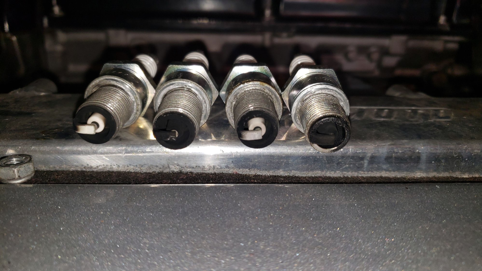

Got the plugs out, these are in order from left to right starting with cyl1
Cyl 3 is a reused plug from last time cause they only had 3 in stock when I replaced them. Other than that it seems to me like Cyl 2 and 4 are rich.. Cyl 4 has fuel sitting in it. These plugs have maybe 2 miles on them and 15 to 20 min of idle time trying to diagnose.
Nothing about the tune has changed since the last time I drove it. In fact I think I reloaded the last known good tune I had just to be sure.
I put a noid light on a couple of the injectors and Cyl 3 looks like Cyl 4. Gets brighter as it revs up.. Don't know what that should look like. It gets pulse but to solid light.
Starting to wonder if there's not something just wrong with the aem, some sensor but if there was wouldn't it just not run at all? Why would only Cyl 4 has fuel in it and not be firing

the same signal supplies cyl 2 and 3 on the coil packs and vice versa. when you go COP you basically double these wires up to make 4 plugs from 2. Id say theres something funky in this wiring thats causing your issue as both cyl 2 and 4 plugs are bad. If your cyl is full of fuel and your plugs look black you havnt got an issue with your injectors theres definitely fuel getting through but your not getting any spark. The issue lies in the ignition. Youve swapped coils and the issue stays on the same cylinder which means its either wiring or the ecu.
Would start with the wiring pull the insulation etc back till you get to where its been spliced and check for any damage or issues in the splice. it might not be a completely broken wire but just a loose wire. Not sure what your wiring skills are like you could either just cut the wiring to cyl 2 - 4 out and re do it or you could run the car and wiggle the wiring around and see if it makes the idle change as your wiggling.
If this all checks out then would start looking at the ecu.
