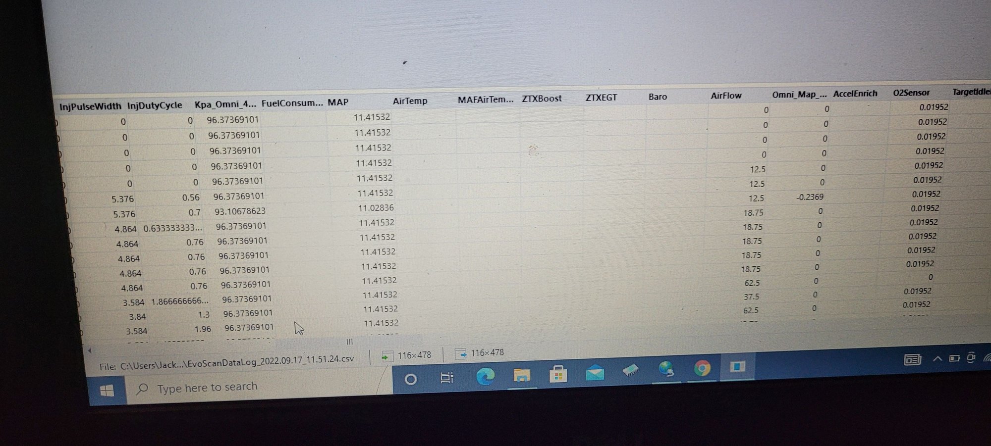

would anyone be willing to look at a couple of my logs just to have another set of eyes on them.
The best way to get eyes / feedback on your logs is to just post screenshots of the relevant sections. If you post them up, I'm sure you will get some feedback.

Here is my log from trying to start the motor
