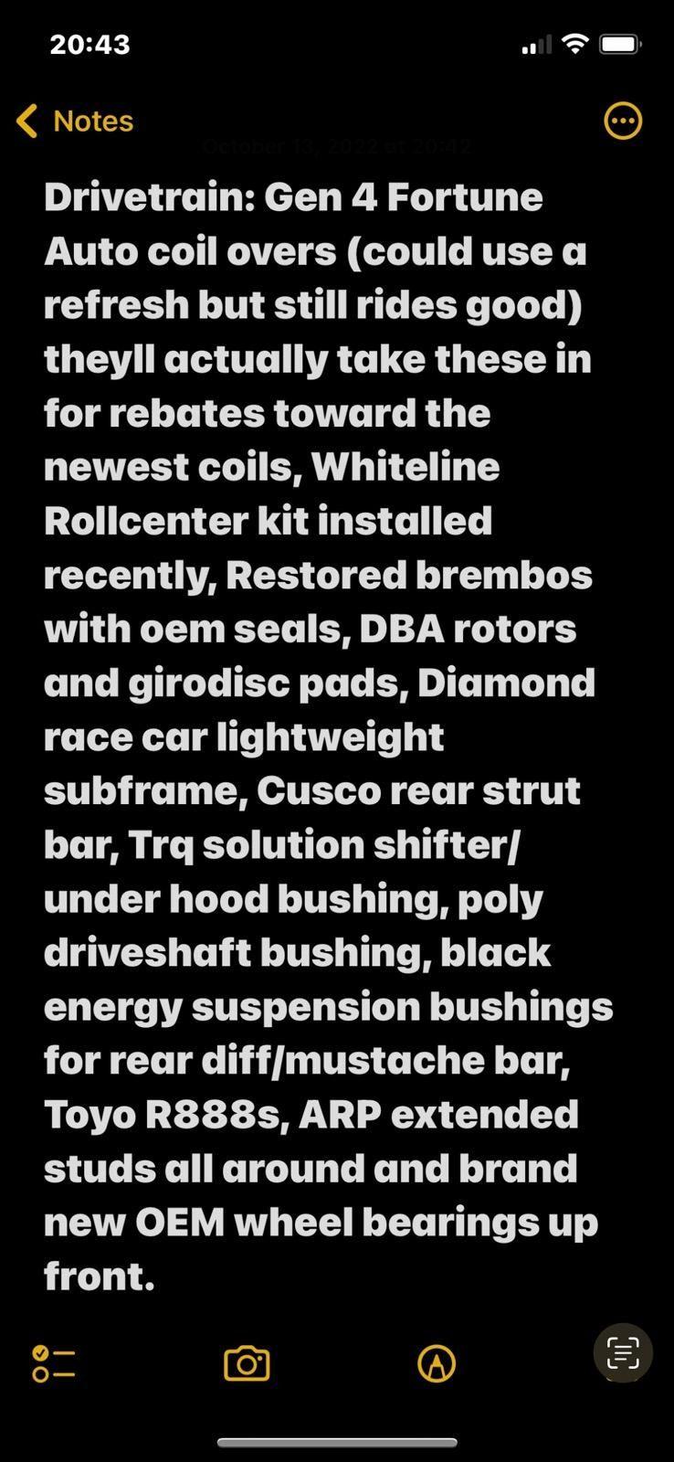

I missed the request. Those are some good suggestions. I'll be replacing all the fluids this week and I'll look into those other items. As for the history, there's not much I know about it since I wasn't able to talk directly with previous owner. It has 94k miles and here's the mods from a text forwarded to me from the previous owner.
Old Nov 21, 2022 | 04:15 PM
That whine may not be a major issue but for sure the Evo has had some work done to it. Built 2.2 loaded in & then removed & a noted stock motor re-installed.
Hey, all in all, a super win & nothing that cant be fixed for sure. Let us know what next steps you are doing & post up what is found
