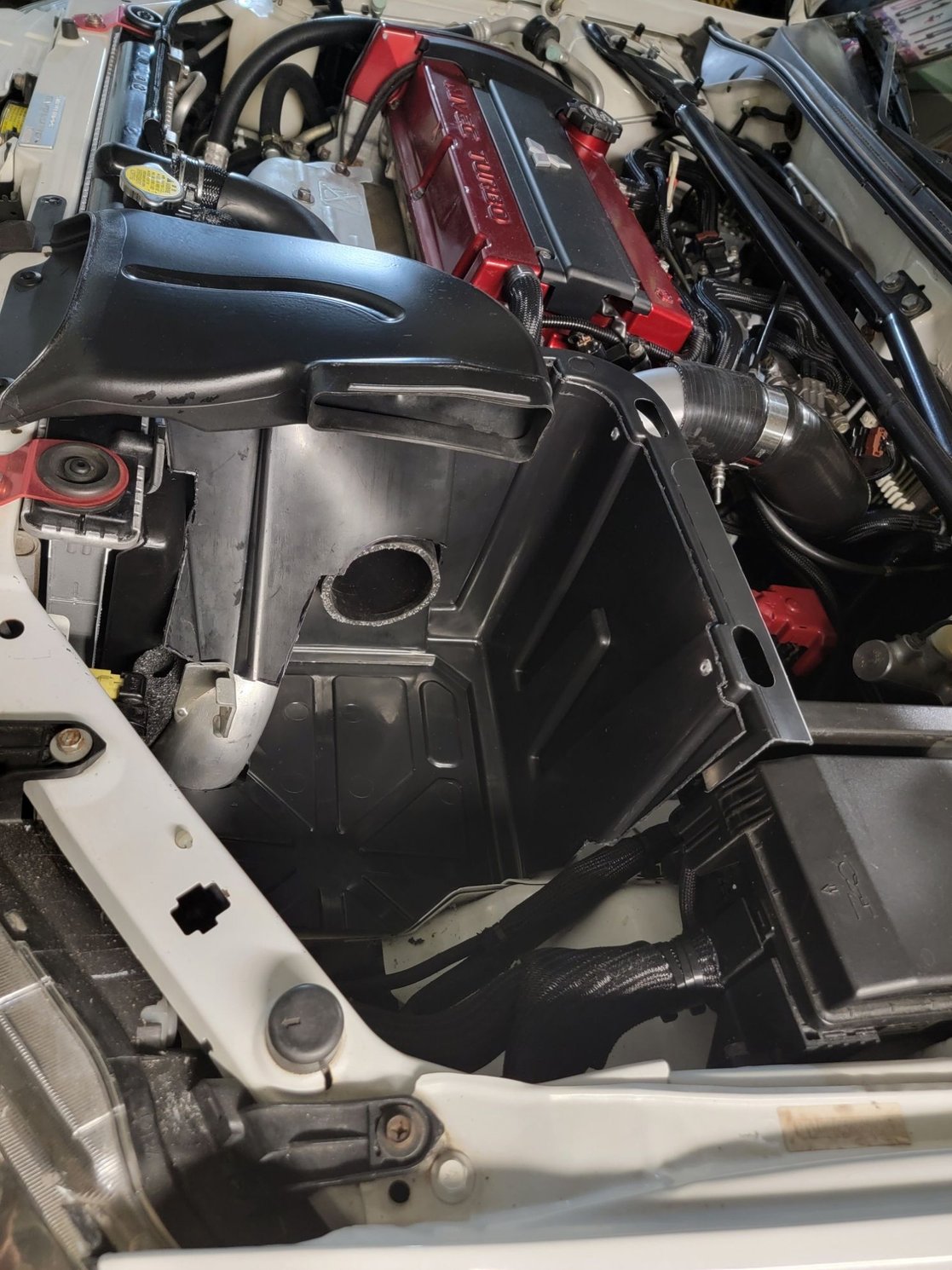

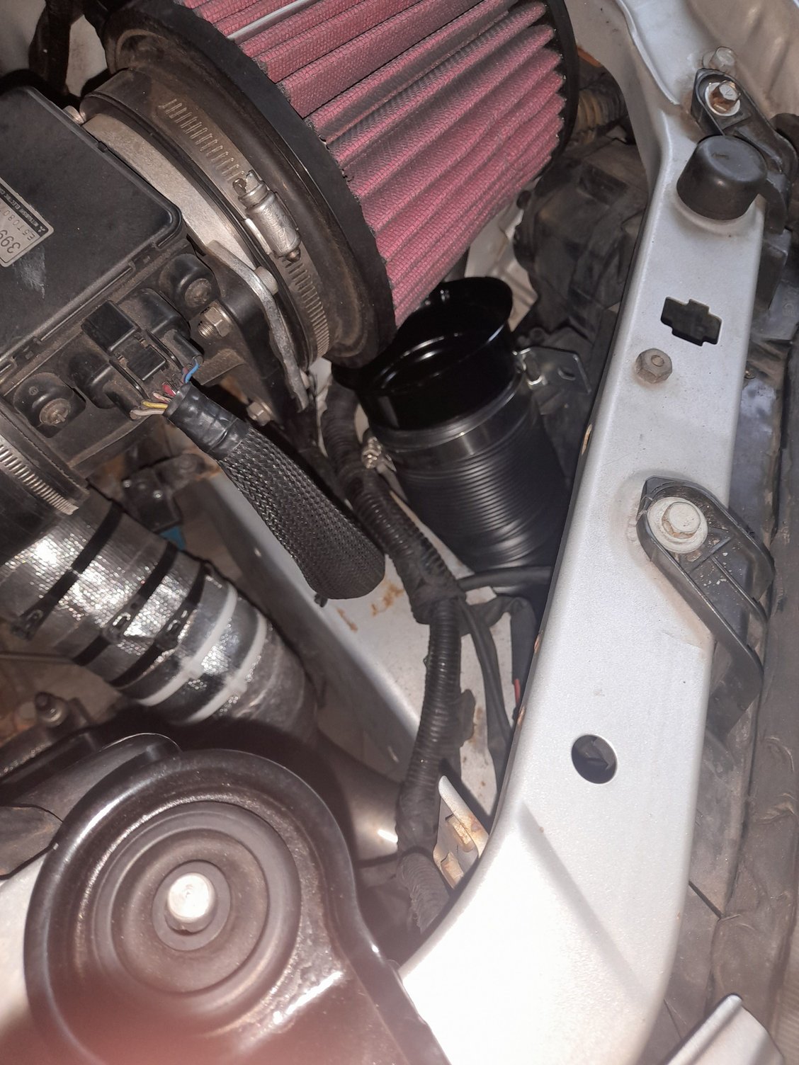

anyone else also done this?
removed the intercooler sprayer bottle and replaced it with this hose
it sits in the position the horn used to sit so it can take in fresh air more efficiently behind the mesh

i got the stock diverter too but too me it looks the air has to make an odd angle to enter
this should be in theory more efficient

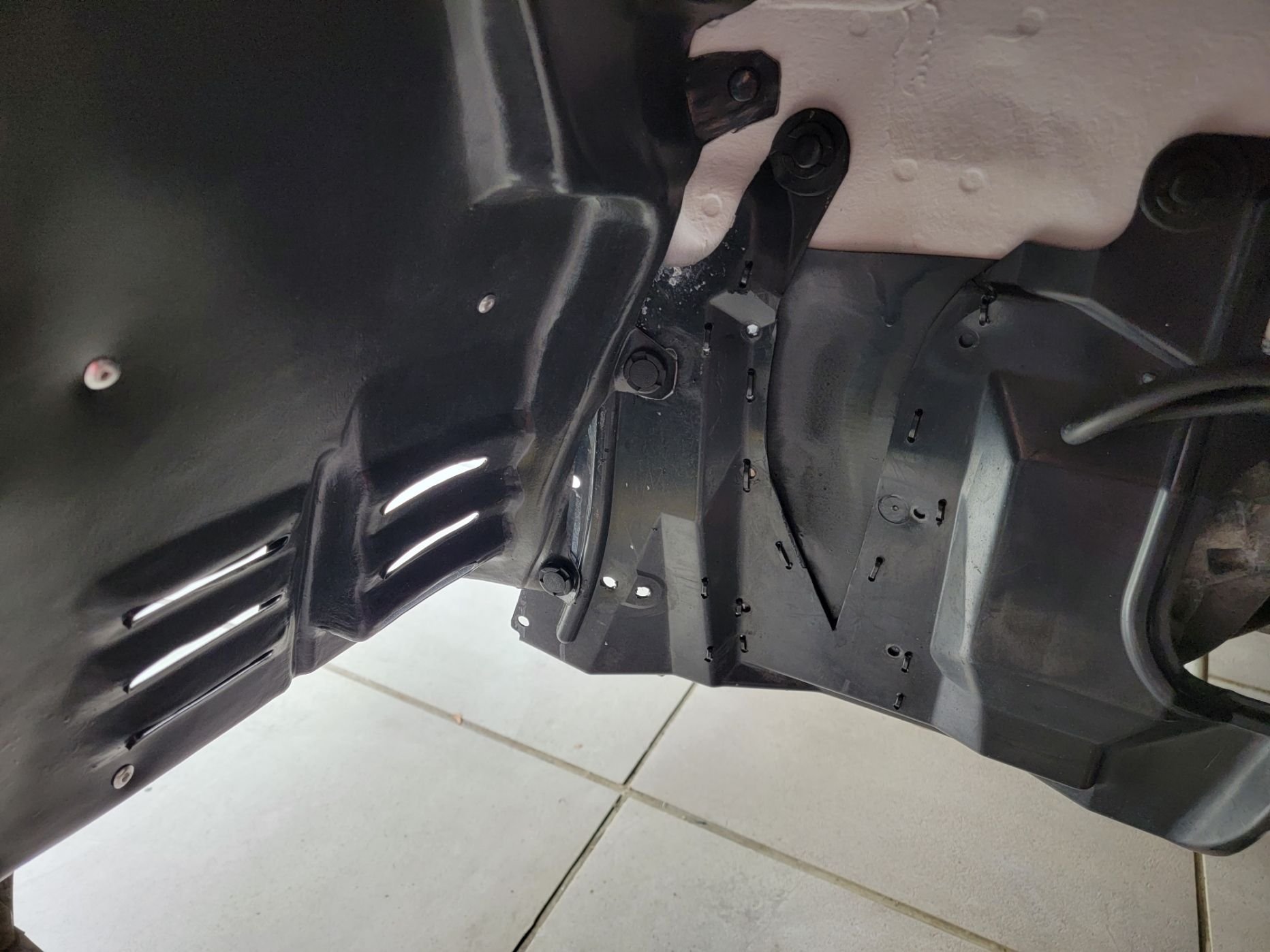

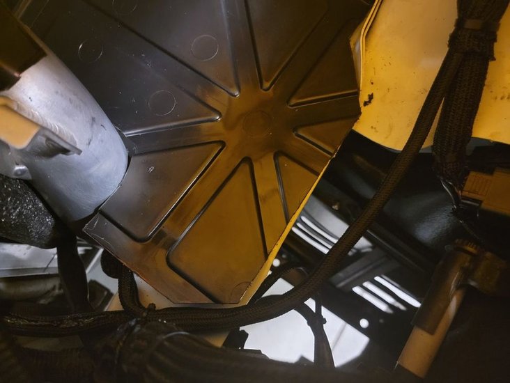

hmm I dont think you need that hose you can slant the fender liner to deflect more air from the bumper to go upwards to the intake. I also added a wall under the frame to separate engine/heat from fresh intake air

I fiberglassed a duct into the bumper opening and connected semi-rigid dryer vent pipe. It worked too well and I had to run a blockoff plate if it rained otherwise the MAF was not happy.

dont have that issue with water
filter is still dry after driving in the rain
