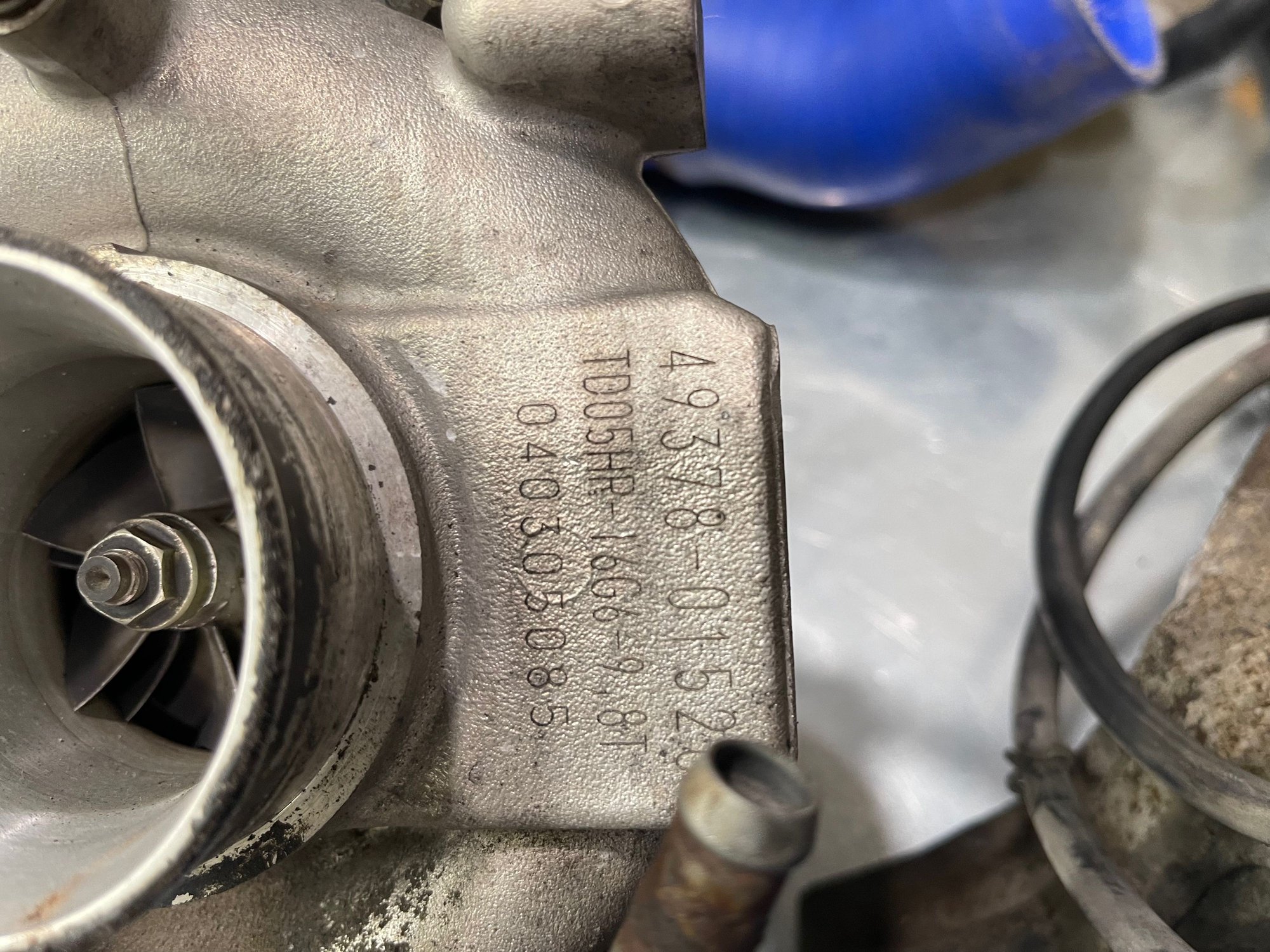

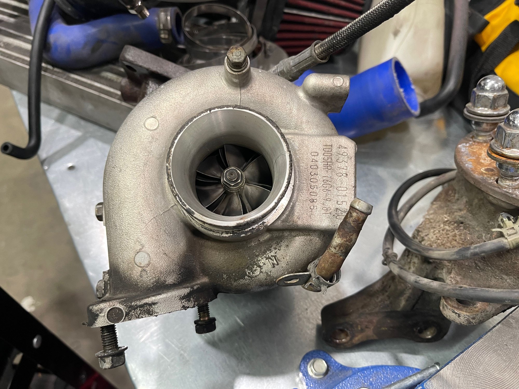

Now looking at the turbo how do I know if it's time to replace it?

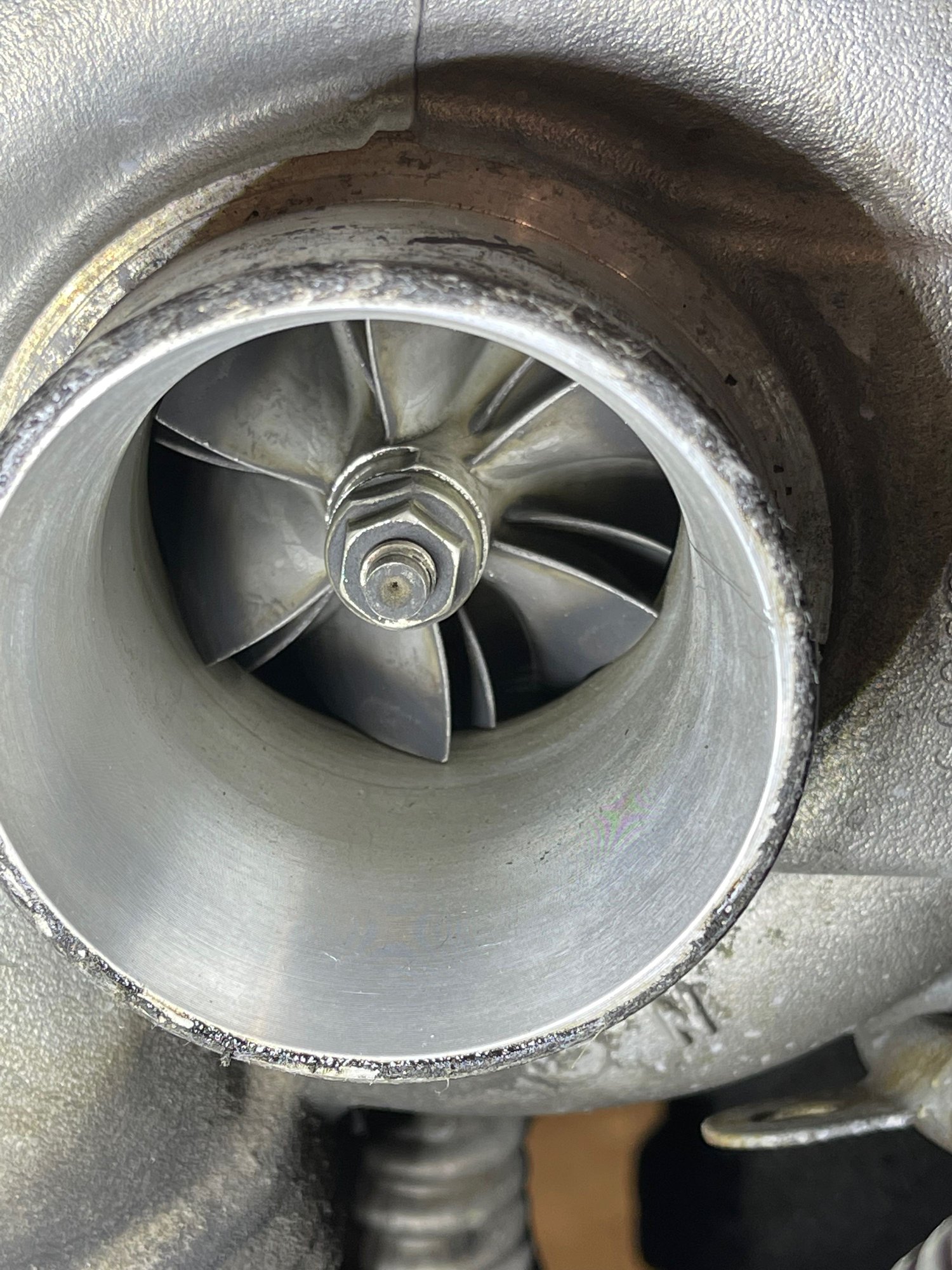

The shaft has some play when you wiggle it up/down but no longitudinal (is it correct word?) play on the shaft
150k miles, turbo looks rusty and dirty
Maybe time to replace?
I'm thinking about new oem Evo 9 turbo. Saw one on full-race website for 1200 (bargain isn't it ?)
Let me know what you think :-)

Minimal Side to Side play is normal, any in and out play is bad. If your thinking about a new turbo/Upgrade I'd look at FP or Art Gennari stock location bolt on options.

Upgrading from the 9.8T to a evo 9 is worth doing regardless of the condition of the 9.8 upon removal. You'll need the EVO9 j-pipe as well.
