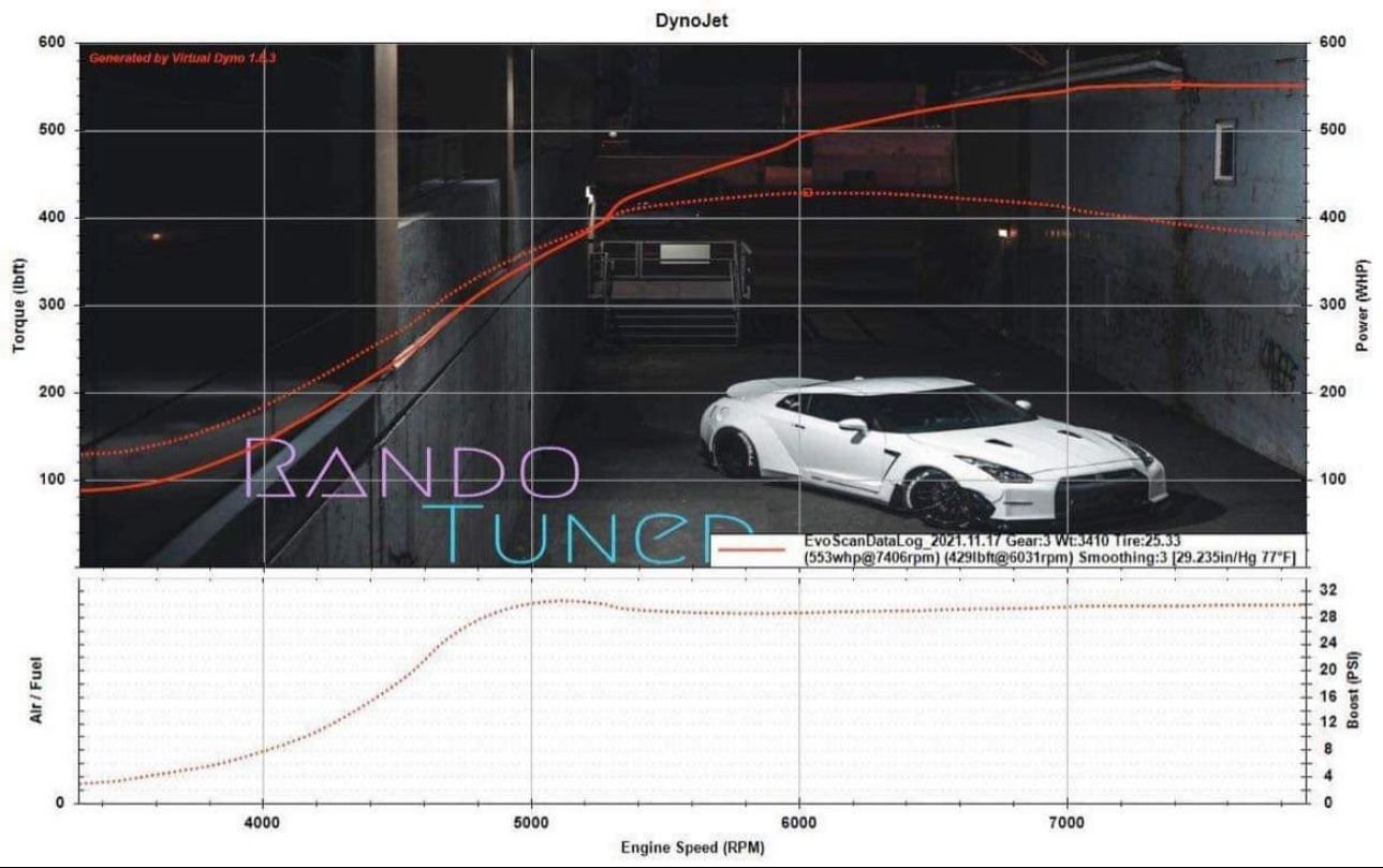

These are my two dyno sheets that i was given when i purchased my Evo IX. my clutch is starting to give out, it’s supposedly currently on an Exedy Twin, i don’t want to go back with exedy, what are other options based on my dynos that i can run with, that won’t break the bank, trying to stay under $2k. i drive it often so streetability is something to take into account. ACT is at the top of the leaderboard but idk what clutch to get THANKS for the help in advance

I run ACT XTSD and I do not like the sprung clutches from ACT, and i've had good luck with them on both of my evos. I have similar torque but a bit less whp than you if that matters.

I had a pretty good experience with an ACT HDSS at a similar power level but it did eventually give out once I went to about 500 lb-ft of torque.
I moved the the Exedy twin after that and like it quite a bit. Why don't you want to go back to it?
I have seen decent reviews of the ACT twin disc but have no personal experience with it.

I’m considering the Xclutch twin for my 8, I have one in our 500+ whp STI and love it. Haven’t seen too many people using em but they’re an Australian company and so far the reviews are all positive from what I’ve seen.

If I lived in US definitely ACT. It's much softer than Exedy
