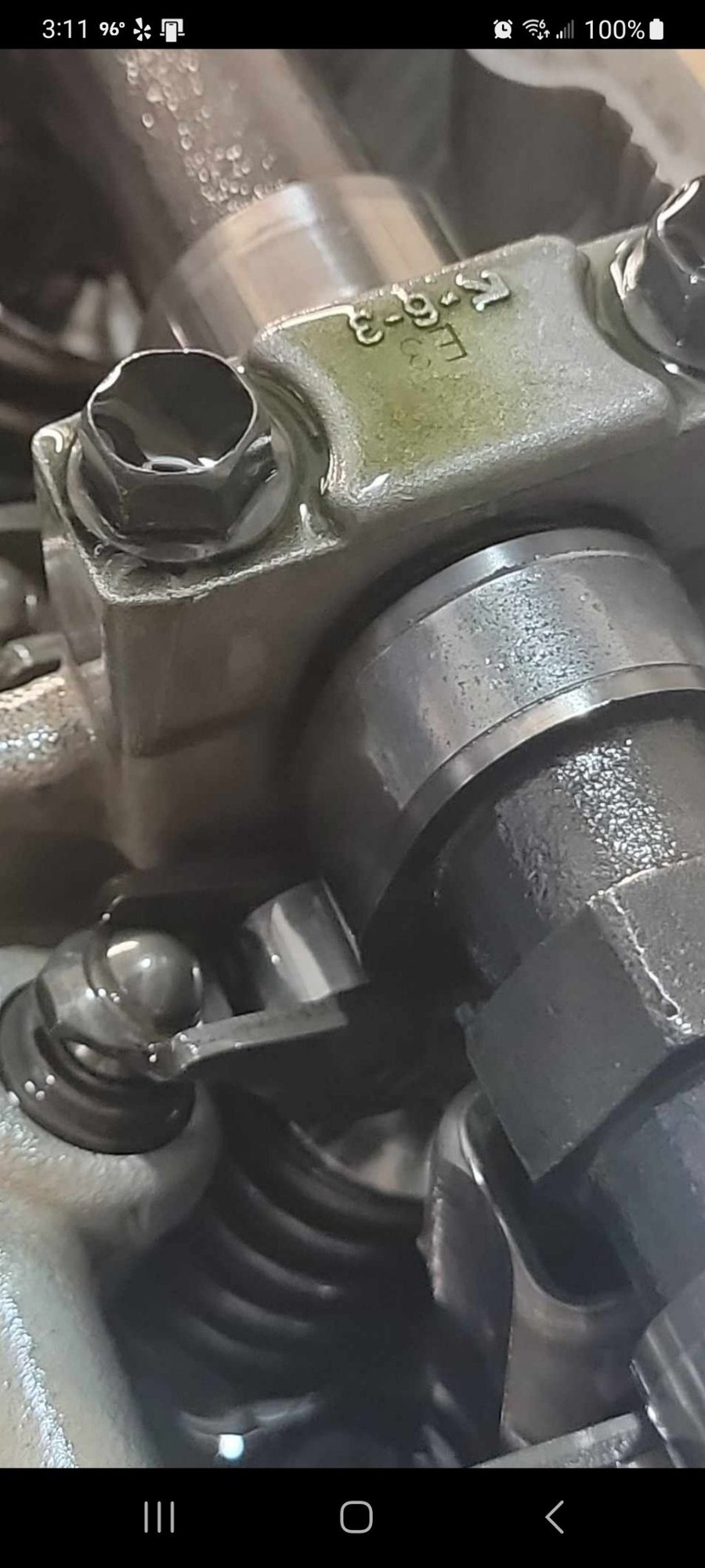

Do it. just in case this is related to the noise
Eww. That cam lobe looks nasty. What cams were those?
Yea, its getting to the end of the season up here so I'll probably add lifters to the maintenance list for the winter.
I have had my valve cover off a fair number of times and have never seen anything like that so I don't think that's it.

V1 of the GSC S2. could be the Manley springs got soft. have no idea
The autox courses are getting faster and in the past year I have been on the 8300rpm limit longer than previous years. 3 exhaust cams (heel/backside only) have this issue, its not scraped but more like 'hammered'
