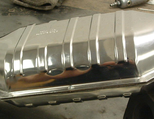

Check out our HF cat. Guaranteed Highest flowing on the market.
Attached Thumbnails Random Technology 3" High Flow cat & CEL?-web-page-pix-146.jpg   Random Technology 3" High Flow cat & CEL?-web-page-pix-147.jpg

I need a clearer pic of the inside
LOL! that looks like a straight through pipe with a cat container cover around it ....
