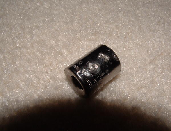

Okay. UPDATE.
A few weeks ago I dropped a 12 mm socket in my engine bay and it never fell to the bottom tray. I looked and looked but did not remove the under tray to investigate further.
Well, tonite I decided to look better. i know the socket fell in the turbo region where ala, the starter is. Well, I found it wedged in between the starter protection shield cover and the solenoid harness. Apparently is was shorting out on occasion. Upon further inspection, the socket "welded" itself to the shield cover. I guess it was "arching". It had some burnt spots on it and melted in some spots.
i got it out and am in the process of putting the tray back on. I'm 100% sure this was the problem.
Do you guys think I did any damage to the starter itself? It looks fine and the wire harness looks fine.

Here look at the socket. Pic not so good. Lesson learned. Be careful not to drop tools into the engine. The way the starter shield is situated, it acted like a mitt and caught the falling socket.
