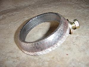

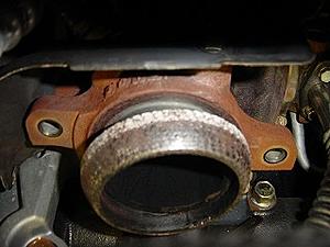

maikonkun's Avatar
Posts: 47
See the attached image to get an idea of what the donut gasket is. To take it off, use a thin lade screwdriver or kitchen knife to pry it off

I just did the install yesterday. and it was a slight glitch. yes just used a screwdiver and pry down on the edge, i just grabbed it and spun it around a few times and it just came off , not a problem. now when you fit things there is a small issue, mine came with 4 nuts and bolts. you can get rid of the springs. and just use 4 regular bolts with the same threads , and the gasket. they should have sent you 2. they are different. i reused all the lower end at the CAT due to the original cat was prethreaded. did install ok, had ok clearance but not much. seem to run good but i will retorque things later. good luck , it as about 1 hr. not that hard but i did wish you could keep the donut gastket. and spring bolts but you have to loose them.

I did not trust the Megan DP to fit up to the stock donut gasket and actually seal well enought. I just grinded enough of the DP flange out at an angle so enough of the donut gasket would fit inside the downpipe. You can do this in about 15 minutes with an air die grinder or drill and a grinding bit. Grind just enough out so that you don't grind into the weld on the DP flange. I've ran it for about 2K miles and went back and checked it out and have found no leaks.
