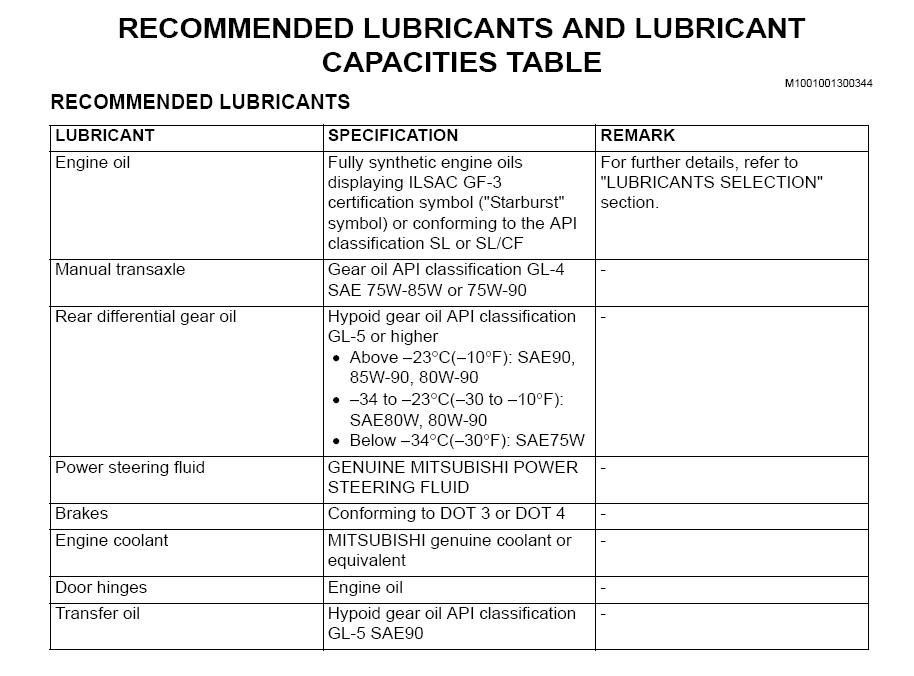

75W-90 oil is thinner than what is required by the manual. I'd change it out ASAP or be prepared to bend over for another t-case.
Here are the specs from the shop manual:

No short term problems. There is a reason why Mitsu lists these requirements. They've probably done the long term testing to come up w/ these specs. I'd try to stick with it.Originally Posted by 93civEJ1

I think I've read enough about people blowing their t-cases while using redline fluids to be concerned. I remember reading a thread where Buschur mentioned he broke two t-cases while using Redline fluids. When he switched back to the OE fluid, the breakages stopped. Take this information FWIW.
