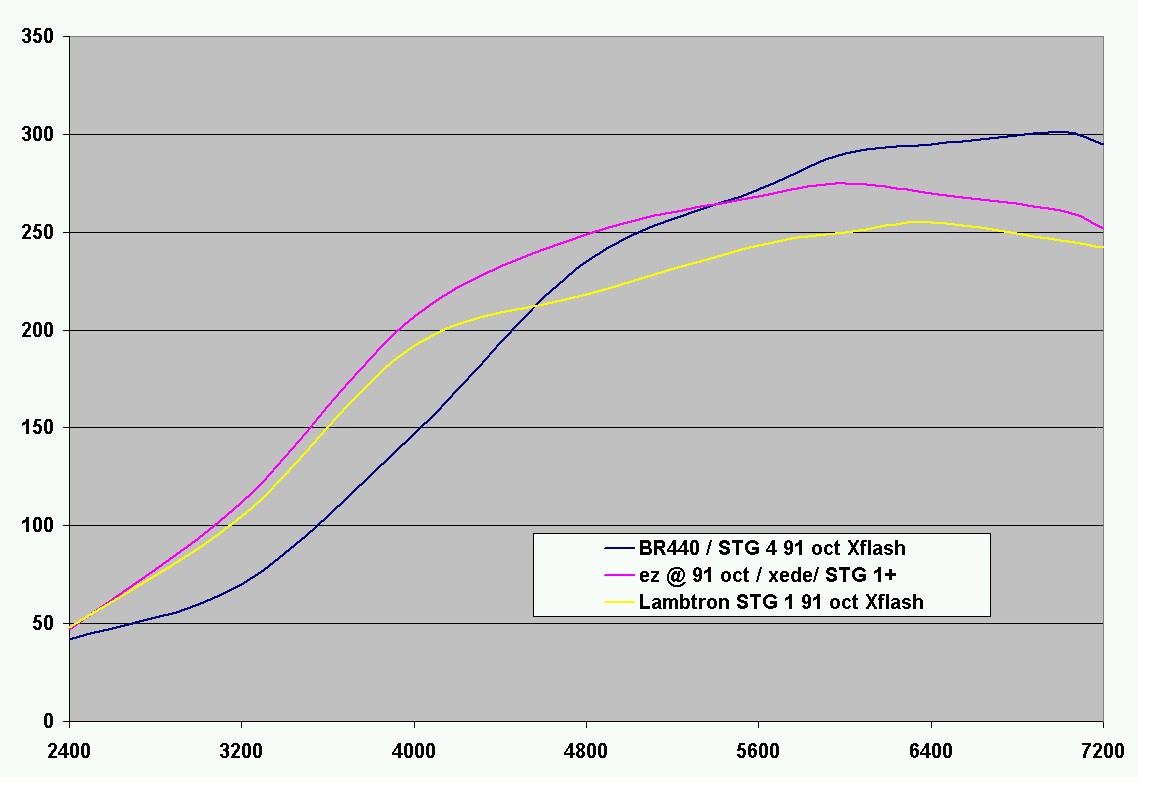

Please read through this 1st, 2nd, this is only an observation made from dyno numbers since the owner hasnt had a chance to reply to my question.
I just did a power plot compare from dyno charts only off of shivs dyno, it revealed a 50 whp loss @ 4k when compared to a stg 1+ set up?
Now the power curve above 6k is by far the better curve & much broader with the BR440!!!
The comparison data that I used was only 91 octane while using a cat.
I am curiuos to know how much you have to give in streetability to achieve a bigger ENZYTE enhanced power number.
I repeat, this is only an observation, please dont flame me.
I would guess that the BR440 is going to cream the other car because when shifted properly you arent going to lose power vs the other. In a roll on contest it'd be interesting. Zooming around the street the stocker will have fun, once you open the Can on the freeway the BR is gone.
