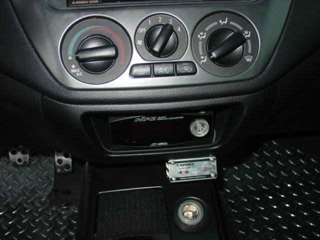

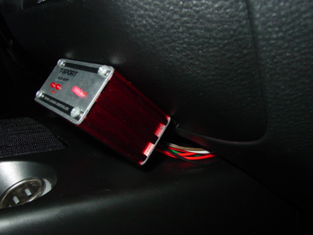

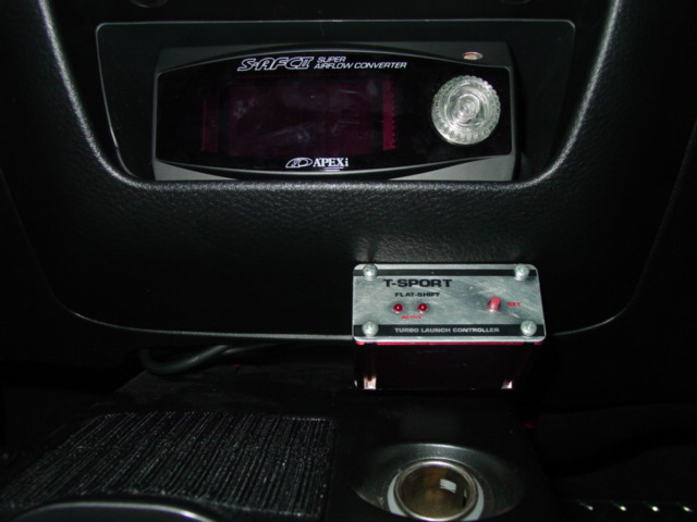

Ok, here are the pictures that I took of the unit.
In these first four pics, you can see where I mounted the unit and how small it really is....
Attached Thumbnails T-SPORT Flat Shift-flat-shift-01.jpg   T-SPORT Flat Shift-flat-shift-02.jpg   T-SPORT Flat Shift-flat-shift-03.jpg   T-SPORT Flat Shift-flat-shift-04.jpg

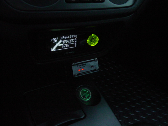

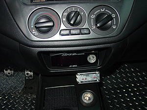

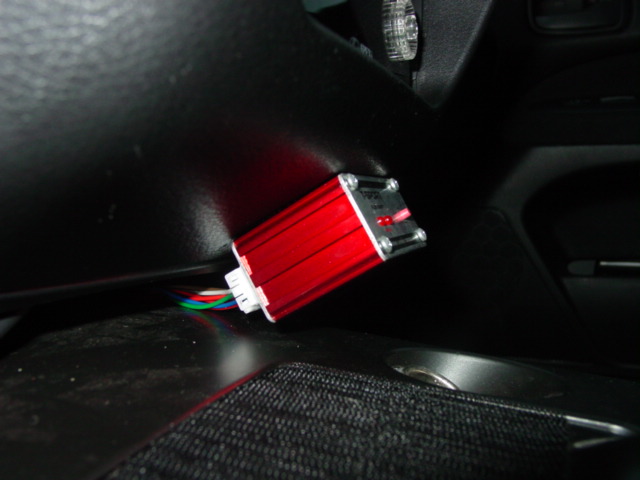

Now, in these pics, you can see the difference between revving to a preset RPM manually and doing the same with the Flat Shift. The first pic was taken with the car in neutral and the clutch pedal extended. Notice the boost (top gauge on the windshield) is still pulling tons of vacuum. In the second pic, you can see that with the clutch depressed, the Flat Shift becomes active and boost pressure builds up. I said 0.7 Bar earlier, but in this pic, I snapped it when it was near 0.5 Bar. Oh well, you get the idea.
Attached Thumbnails T-SPORT Flat Shift-flat-shift-05-inactive-.jpg   T-SPORT Flat Shift-flat-shift-06-active-.jpg
Old Sep 17, 2004 | 05:51 PM
90GSX-03EVO's Avatar
iTrader: (27)
Joined: Jul 2003
Posts: 2,217
From: Virginia
Here's the last pic. This is what the Flat Shift looks like when it is active. The 2 LED's on the front of it flash on whenever the unit is cutting fuel and spark.
Notice that on the S-AFC 2 right above it shows the RPM's are at around 3900. This is part of the stutter feature. My preset is at 3,500 and it blips between around 3400 and 4000.
Hope these pics help. Any commemts or questions?
