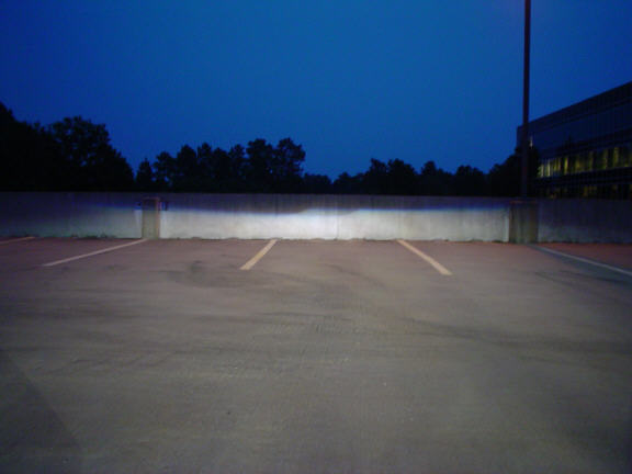

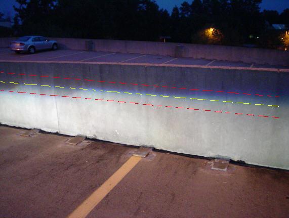

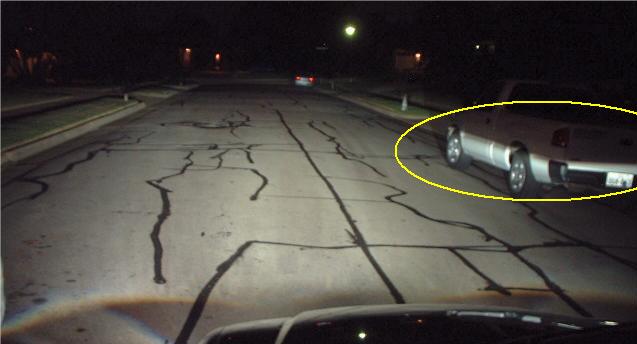

The HID projectors used in the Evo's are made by Stanley, which is also the company that makes projectors for the ones used in Acura TSX; and the co-manufacturer of the projectors used in Honda S2000 (Kioto/Stanley).
The Evo projectors are one of the most wanted projectors within the HID-retrofiting community for its colorful prettyful beautiful sexy cutoff band and the very very very clear lenses, hence great illumination.
While others may prefer sharper cutoff line, smaller cutoff band and wider beam pattern, these people go with the S2000 projectors.
Pix illustration:
1. red = cutoff band, yellow = cutoff line (Evo)
2. Evo projectors, i'm sure most of u r familiar with this light pattern.
3. S2000 beam pattern. Notice the dull, yet much sharper cutoff, and wider light output.
