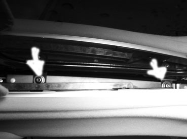

Because it looks to me that you can remove the glass by taking out these screws in the picture, but then again, I've never done it before. And I'm sure I'd have to adjust it once it's back in. What do you guys think? Anyone done this?

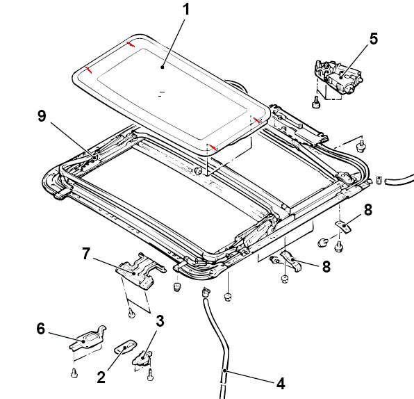

Here's the assembly diagram from the shop manual I have, the screws are indicated in red.

btw you can take the sunroof out by removing those 4 screws...it will just pop right off. Problem is that they are a little hard to get back in there while it is all still on the car.
