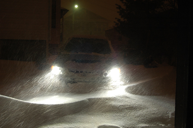

we're having some serious blizzard in Boston, last night I took my Evo out during the storm, no problems, someplace have 1 and half feet of snow and some place had 2 feet, never got stock.........
Attached Thumbnails Won't stop in snow-dsc_0107.jpg   Won't stop in snow-dsc_0101.jpg
