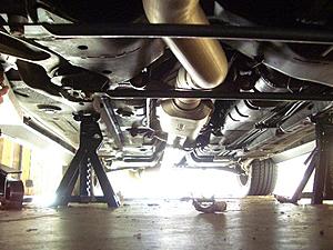

Here's a pic, you can see pretty well where I put the stand:

^^thats where I put them this last weekend when I put on my exhaust, it was very stable.

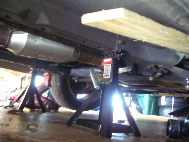

different angle

what i do is jack the front up by the metal plate that is under the engine, there is a little plateu that comes down from it. once in the air, i place my jackstands on each side behind the tire where you would normally jack up the car to change the tire with the cheapo jack. for the rear i jack up at the rear diff, place the jack stands in the same spots, but for the rear of the car.
