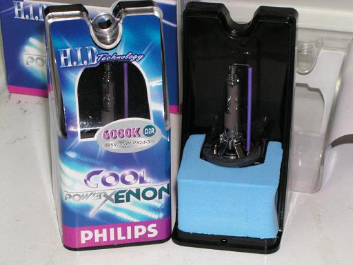

4150k is the stock temp. i just like how the 6000k lights the road because im used to my wifes lexus is300 that i upgraded in her car. i understand the light issue, but the difference in lighting the road is actually minimal compared to the 4150k lights. i have done the research prior to upgrading the wifes lights and havent had one problem with hers in her car. i also went with the philips ultinon bulbs which are a bit bluer than the stock bulbs not purple like some think. the purple is the 8000k bulbs which i do agree that you get less light output more color with those bulbs. as far as it being rice, i beg to differ.
Attached Thumbnails HID upgrade problems!?!?!?!-lex-lights.jpg   HID upgrade problems!?!?!?!-lex-bulbs.jpg
