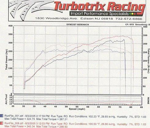

ok everyone i have a 2005 evolution 8 2500 MILES, with the following mods:
aem short ram intake
greddy type s blow off valve (single spring mod done)
hks 280 cams
greddy profec b spec 2 electronic boost controller @ 21 psi
megan racing EXHAUST::::
3" O2 housing
3" downpipe
3"cat delete pipe
3"cat back without the silencer
WALBRO 225 FUEL PUMP
PERRIN 02 SIMULATOR
TUNED TODAY AT TURBO TRIX IN NEW JERSEY
THE FIRST SHEET IS WITH AND WITHOUT THE FUEL PUMP
THE LAST SHEET WITH A SINGLE RUN IS THE LAST ONE THEY PULLED
NOW LOOK AT THE RUN CONDITIONS IN THE SHOP TEMP WAS 102 THEN 105 DEGREES........ AND THE HUMIDITY WAS 7% ??? OFF? IM NOT SURE...
BUT NONE THE LESS IT WAS AN EXTREMELY HOT DAY AND IT WAS MAYBE 95 OR SO OUTSIDE AND I KNOW THAT SHOP WAS HOTTER INSIDE.
WHAT ELSE CAN I SAY I THINK I WOULD HAVE PULLED A GOOD 360 HP ON A COOLER DAY WITH LESS HUMIDITY....
ANY QUESTIONS LET ME KNOW
gOOD LUCK WITH YOU TUNES
Attached Thumbnails my dyno charts from today-first-2-runs.jpg   my dyno charts from today-final-dyno-run.jpg

nice numbers! the peak torque seems low, but the curve looks nice and flat. interesting....
you're not gonna get much less humidity than 7% though.... i think that must be a mistake and it was probably more like 70%.
edit: is this on the stock turbo?

Stock Turbo Yes The Only Mods Are The Ones Listed I Wanted More Torque Though Does Anyone Know How To Get The Torque Up There???????????

wonder if the 280 cams are hurting the torque? the 3" exhaust setup might be costing you some low end too, but i wouldn't think that much. hmmm....

torque low due to dyno?
don't know, they look low.
it seems like you would get more whp with cams though the tq.

good numbers man, but the peak torque seems off by like 30lb ft?

how are those 280 cams at idle? are they tuned?

were the cams at 0,0? i noticed a loss of torque with mine, but they pulled great up top. i ended up throwing back in the 264/272 combo for torque.

is ECU stock or Reflash or what?

if you want more torque i you think you would try alkohol system

ok u have cams on me, o2 housing, cat delete , 10.5 hotside and a different tune. i am tuned by al . ok so i ran almost 50 more wheel than i did, wtf. is all that stuff i dont have that u have really worth 50 whp? damn

want more torque, twist some cam gears back to a -3,-3 retard.
Also, taht is a nice flat torque curve, even if it is a little low...

im pretty happy with it i am going to go to atco raceway tonight to make a couple of passes with it and see how she runs
i post the time slips when i get back
and hell yea the next upgrades are the alky kit and a clutch...figure ill burn this one out first that will bring the numbers up a lot im sure
