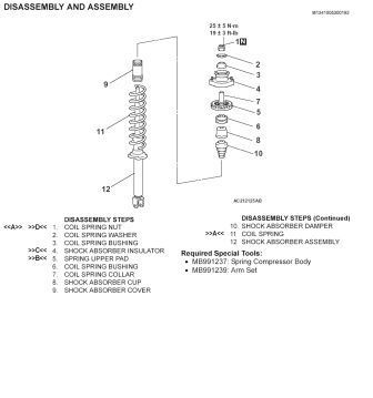

ok the circled part is the part that moves up when i push down on the back of the car. its already up ailttle bit since u can see the silver part of the shaft.

did you put the rubber bumper back on the underside of that shaft?? there should be two rubber bushings-one to go below the bodyline and the other goes on top as you have pictured. ???

is it yellow? i cut the yellow one in half. and its on the underside

Your problem is that you didn't reassemble the shock correctly. It's probably the dust cover not installed. Happened to a friend of mine.

ok so theres supposed to be a dust cover on the top. is that it?

no not the yellow one, should be another black one and a dust cover. so it would go together like this- hope that helps
