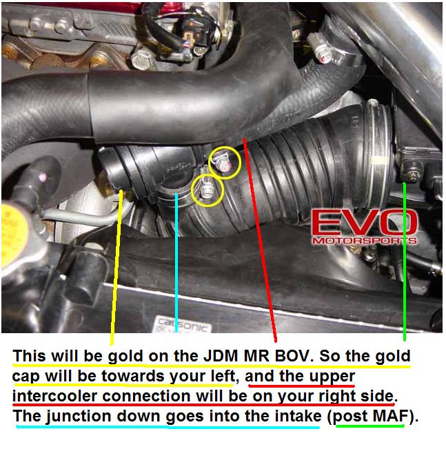

The stock bov is located off of the upper intercooler piping. Go next to the battery, and under the aluminum intake there is a hose off of it, follow that hose to a black plastic unit with a vacumn line going to it. You will notice that goes into the intake post MAF, that is the dv (diverter valve - aka bov). BOV's are post turbo, and mounted to the intercooler piping before the air goes into the engine.

What do you want to get out of your bov? I needed better holding power because I run more psi and whatnot. Sound was a side benefit. If its just to hear the whoosh sound then I would change to the cone filter and leave the stock dv in. If you plan on adding a boost controller and to run more boost, or yours is leaking, then an aftermarket will correct that.
The pic is for Evolution888, sorry to put it here, but its a really ghetto mspaint job.
