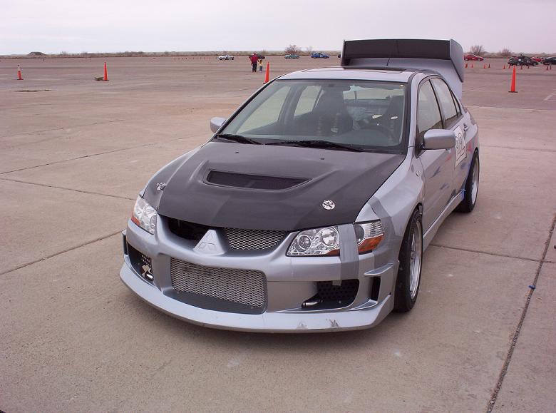

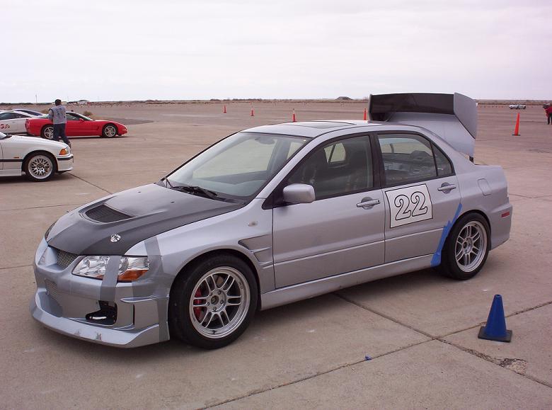

by the looks of those pics, it looks like you should be able to make it fit. from what i can tell is that it may be hitting something from the back side thats not letting it line up. i had this problem with my chargespeed bumper. i had to trim the backside and eventually it fit better. remember fiberglass molds are never perfect. there's a lot of "massaging" to get them to fit right. of course some manufacturers are worst than others. also don't ever expect aftermarket body parts to fit like oe parts. that'll never happen.
also a word of advice, you said you plan on autoxing that car... i wouldn't with that bumper. the first cone you hit, it'll crack in half. i know cause when i built that car, it orignally had the chargespeed fiberglass bumper. my 1st event i shattered it on the first run. thats why it had tha veilside urethane lip on it. urethane is much stronger

this is what i had to do to finish the event after i hit a cone...

It cracked in 4 spots from 1 cone...
