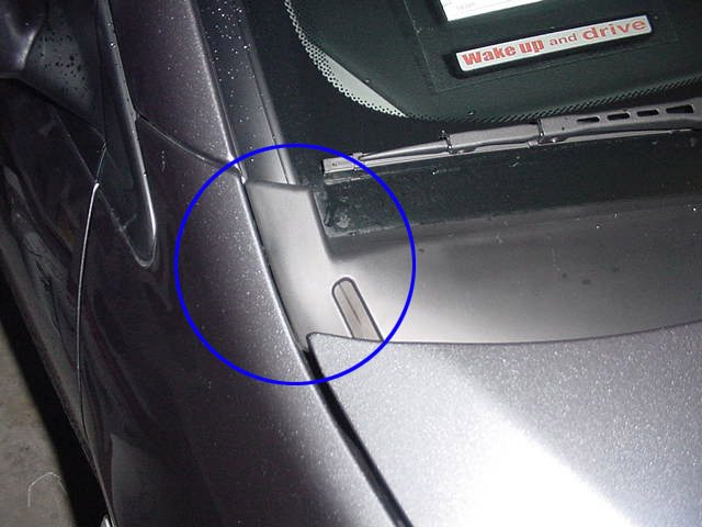

my evo9mr has the tapping noise that sounds like it's coming from the windshield sometimes. almost sounds like the wiper blades are rattling against the window. i posted the tsb below.

for the rattle, found on another thread
TSB-05-42A-005 Released March 2005 (titled: Winshield creaking noise while driving)
1 Test drive to verify noise is coming from A pillar area
2 use a soft trim stick to remove the side windshield moulding from the cowl trim - do not remove the cowl trim for this procedure
3 obtain adhesive-backed thin felt material from BSR kit (MR991752) Cut six felt pieces, approx 70 mm x 5 mm
4 Remove the liner from the back of the felt pieces. Affix the felt on the inner clips. Affix one felt piece to each of the three inner clips Repear on the other side.
5 Be sure that the outer moulding clips (four on each side) are securely attached to the body retension stud. IF the clips are not properly attached, noise may result
6 Reinstall the windshield side moulding
7 test drive to verify the noise is eliminated.

oh the headlight thing makes alot of sense......and yea.....my friend who is a honda mechanic told me it is coming from the drivers pilar area......so that TSB looks like it is right on the dot.....thank you SO much for your help everyone~

I had the problem with the windshield creckin in the VIII and think I might have it in the IX.
With the VIII, Mitsu released a TSB, so I got it done and the rattle went away.
They forgot to put this felt between the window and plastic that holds it.
Don't know why they would forget again.
The job only took 20-30 mins at the dealer.
The only problem is there is no TSB yet. Last time when there was a TSB, I had a hard time convincing my local dealer that there was one. I had to drive there 3 times (hour away-60 miles) even though the first time I called them I gave them the TSB number and told them I'd like to make 1 trip.
