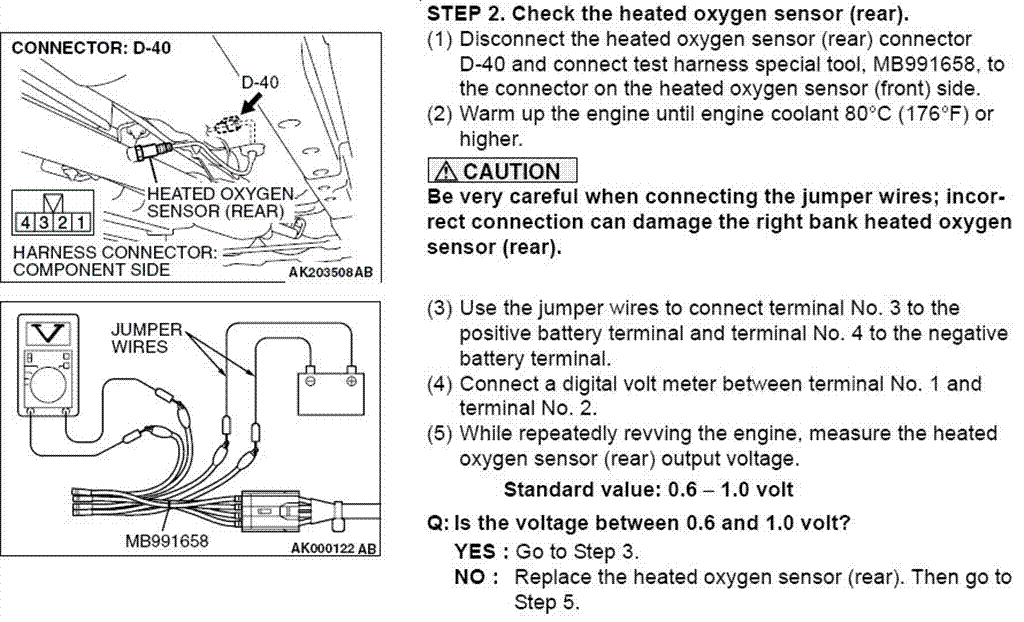

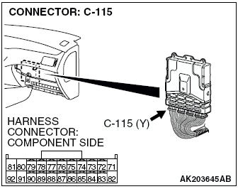

I don't know where you might get the harness from, but here goes (see attached).
step 1 basically makes sure that you've got the code
step 3 checks if the connector near the sensor and on the sensor are okay.
step 4 checks for grounding between #1 on D-40 and #75 on C-115
Good luck
