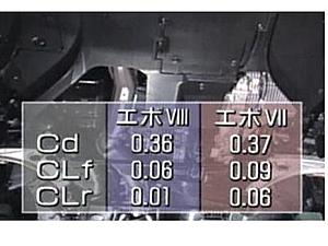

Best motoring video there was a chart. I dont' understand it but i could be wrong. CD on first column and smaller cd #'s below. Can someone read japanese around here? I can post pics of the chart.

gtr's Avatar
gtr
Joined: Jun 2001
Posts: 2,452
Originally posted by SRD
nope,
post it anyways!
Attached Thumbnails Did i read wrong?  We have a CD of .36?  That sucks.-b2.jpg

The Japanese says :
EVO VIII EVO VII
So I reckon its comparing the differences between the Evolution 8 and 7.
If there's more print I could tell you more.

What is CLF and CLR ? Anybody?
Old Apr 11, 2003 | 07:51 PM
erikgj's Avatar
Joined: Aug 2001
Posts: 1,003
CLF=Coefficient of Lift front
CLR=Coefficient of Lift Rear
As for the high Cd remember these cars are made for rallying. So speeds above 120 mph don't matter too much. But efficiency at low speeds, cooling and not dropping downforce at high slip angles mater more. This car is not built for Le Mans but the Rally of Monaco.
