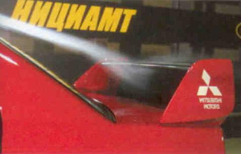

Originally Posted by honda-guy
maybe the reason why the sti had more rear end down force is because it had more lift on the front end which transfer the car's weight to the rear. just a thought.
I don't a lot about this stuff, but if I remember my physics -- downforce from a wing is causes from air moving over it .. which causes low presure under it, pulling the wing down. This is how an airplane wing works, just turned upside down.
So based on the pictures:
And:
It looks like the STI wing has more air running over the top of it, causing more low pressure under the wing, "pulling" the rear end down.
That's my best attempt at an explination anyway
Yeah, I think that is definitely part of it. IIRC, Subaru also cleaned up the underside of the STi, so it should have better airflow under the car, which will greatly contribute to downforce. Looks like the Evo still suffers from the "parachute" effect of the rear bumper at high speeds. It would be great to see an Evo tested with all permutations of vortex generator/splitter/rear undertray.
Great find on the article, btw!! Cd of .383 ... ... much worse than I thought it would be.

Originally Posted by byron3636
It has to work like that, unless you're willing to say those forces will actually make the evo's frame flex.
It doesn't have to. Theres no fulcrum in the center of the car. There would have to be some kind of pivot point to transfer the energy of the front lifting to the back. Instead the whole car just comes up. In this case, if anything, the fulcrum being the rear wheels.
As far as the wind traveling over the wing, it works the opposite. You want more wind under the wing traveling faster. Thats what creates downforce in the reverse fashion an airplane wing works.
There are many factors that determine the lift or down force of an airfoil/wing. Factors such as thickness ratio, aspect ratio and camber are physical attributes of an airfoil. In an automotive application these factors are probably very similar between similar vehicles like the Evo and STI. The other two major factors are airflow condition and angle of the attack. An airfoil can generate more lift/downforce in a laminar (smooth) flow vs turbulent flow. Looking at the pictures it would appear that the STI’s rear aerodynamic maintains a more laminar flow while the airflow over the Evo’s rear is starting to separate. I guess the little winglet on the STI is doing it’s job.

Vortex generators dhould change things a good bit. The air is going over the wing much cleaner on the STI due to their upper windshield wing thing which does the same thing as the VG on the Evo. The Evos flow should be much better with the VG
