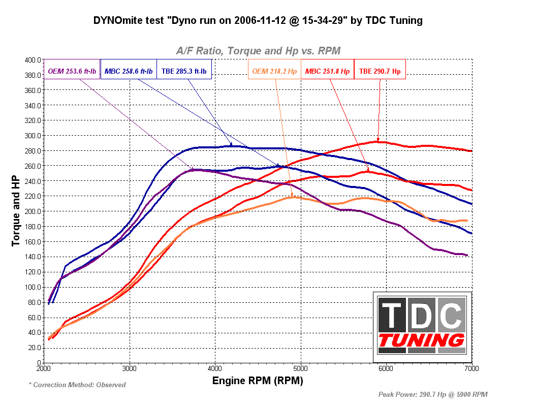

dyno results 05 evo any comments on the results?
here are the latest dyno results on my car (93 gas). the attachment shows stock, mbc and ecuflash tune and finally mbc, ecuflash re-tune with ebay turboback. STOCK CAT in place so not a true tbe (i.e test pipe). i am very please with the results and the car pulls really well

sweet, where in nh are you..
is that a dynojet

how much boost you running?

It says Dynomite dyno on the sheet.

23 to around 20

Very nice. What did the reflash cost? Any street-ability issues with the reflashed ICU/

100 for an hour on the dyno with reflash

I make 254 ft-lbs @ 4250 and 239 whp @ 5600 on a flash, rest stock 2005 MR so very comparable to your numbers i think. MBC/TBE would net me in the 290 ft/lb and 275-80 whp range after tuning I believe. I use Ecuflash and a base flash ROM from a tuner that came with the car, since modified by me :-)

what is dynomite never heard of this dyno.

The company that makes it is called "land and sea". AMS (gaithersburg) has that dyno in there new shop

it looks like it reads high like a dyno jet.

That torque curve flattened out nicely

At AMS a stock V8 hemi charger only put down 325whp. Its rated 425 crank. Thats a big % loss. Thats close to a 25% loss to the wheels
