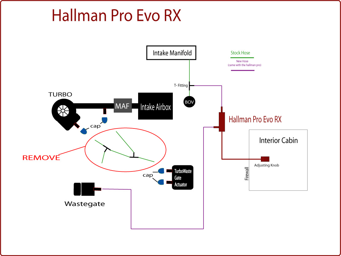

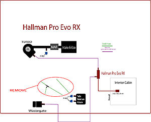

Wow...that was a clean install and i really like the red vac tubing. But as a peice of advise I would not use the vac line from the manifold to the BOV as your source as pressure. See all a boost controller does is bleed off pressure and the reason that line runs from your manifold to your BOV is to keep pressure on the BOV to help it stay closed. So when your boost controller starts to bleed off pressure to control boost you are actually reducing the pressure on your BOV which can make it leak at higher rpm which will cost you power. You should use the turbo nipple as your pressure source for your boost controller. By the way where did you get that vac line? LAter

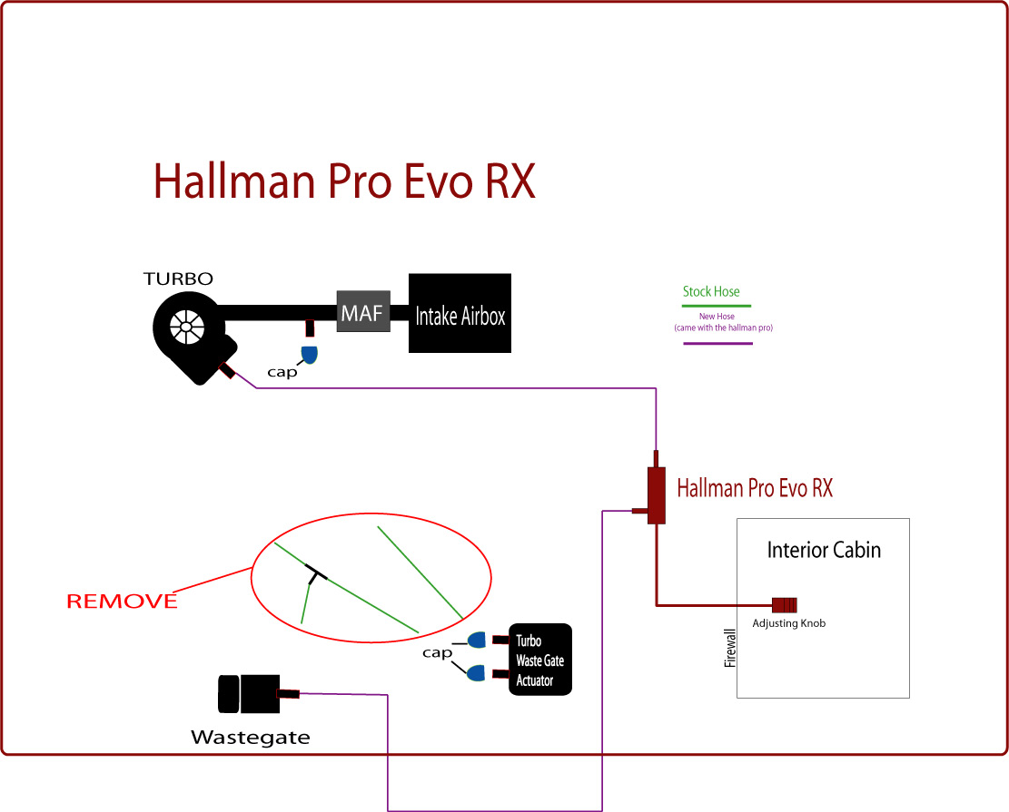

thanks for the advice i had to choose between these 2 diagrams below and there were many mixed emotions on which one to use but i chose to use the bov line anyone else have any feedback for me or suggestions any advice would help

How did you cap off the stock port from the stock LICP?
Could you have created a boost leak from removing your ICP?
If you still have the stock LICP on the car put the source for the MBC to the stock port and get rid of that Tee of the BOV control line.
