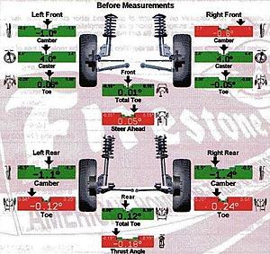

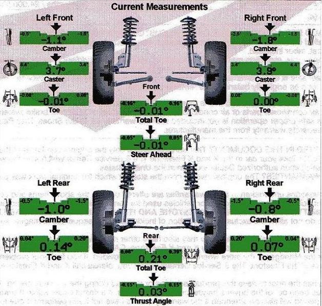

Pictures show the before and after. Technician said my atrocious wheel alignment was the reason why the inner side of my 4 tires were wearing out rapidly.

That toe will murder your tires pretty quickly.

so how did you get this broken ankle alignment?

Probably from the factory like my Evo and many others.

it was THAT bad, you still have more toe in the back than I like. I prefer a car strait up zero front and back.
That was my first time doing the wheel alignment since I drove it off the dealership lot.

my car off the lot was way worse than yours...

I've said it before......two standard factory options not listed on the window sticker are bad paint and bad alignment.

My toe was WAY off from the factory. I only got 16,000 miles out of the Advans because of it. I know this is more than some people get from the OEM tires but I never tracked or raced my car. If I ever buy another Evo I'm going to drive off the dealership lot and directly to a tire shop for an alignment.

I know the "after" is all green, so it must be good, but I don't like they fact that the left and right settings are so different. And I prefer zero toe f/r, too. Looks like they upped the -camber on the right front but not the left...weird. Front camber has two settings (~ 1- and ~ -2), unless you have camber plates. I'd recommend the -2 setting for best performance at the cost of minimal additional wear.
On second look, I see they bumped up the r/f -camber because it was way low. Looks like either a bad reading or r/f sustained some damage at some point.
The settings are different so when he sits in the car it will balance out
