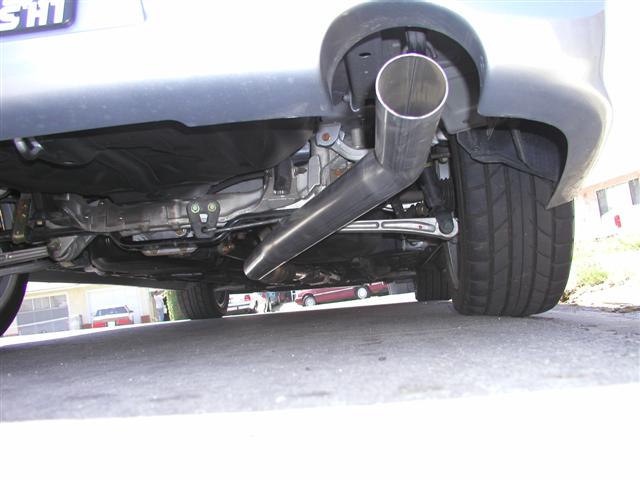

Here is the pic
Here is the thread
https://www.evolutionm.net/forums/sh...threadid=23860

Originally posted by stvbreal
It's gonna be loud no doubt and it's gonna look odd with no pipe out the rear. If a cop hears that and then sees no muffler or pipe out the rear yer best bet is yer gonna get pulled.
Reheat has got it right. That is the way to go for sure. How much did that cost btw? Couldn't be much. I think every one should at least hear what a turbo car sounds like without a muffler. The stock turbo absorbs most of the noise anyway. Anyway aren't most catbacks for turbo cars a straight muffler?
Old Jun 20, 2003 | 11:27 AM
iodine23's Avatar
Joined: Oct 2001
Posts: 776
From: Austin, TX
k_fabec: The thread said it was like $60 bucks for the setup, and the 3" pipe was welded in after the 1st resonator. I think most aftermarket catbacks have straight-through mufflers, yeah.
