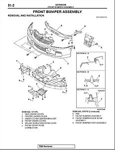

Ok people.... searched the forums in and out, and can't find how to remove the front bumper on an IX. I've removed everything I can find on a removal guide for a VIII (http://forums.*******.com/showthread.php?t=5113), but something is still holding on in the middle inner portion. I think I found 2 phillips-head screws, but theres no way you can get to them....
Any help would be much appreciated. Link me, do a quick write-up... anything!

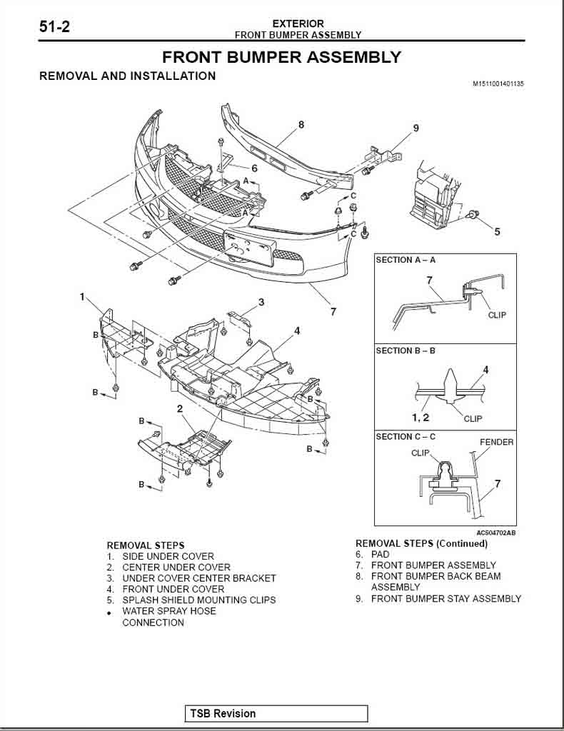

here ya go
try this ....

there's one on each side behind those clips in the front, stick a socket in there and you can reach them...

if you have the 2 screws out of the wheelwells, the two from the top, and the two behind the clip in painted pieces in the front then you should be set. After i had all these out and all the clips i just wiggled and it kind of popped off. Its real easy once you do it for the first time.

Got it! Thanks for the support all.
My issue was the small circular pads that you pop OUT of the front bumper with the bolts behind them. Nobody posted pics of this. I will when complete... I bought the wrong damned headlights (9007 instead of 9006) Yargh!
