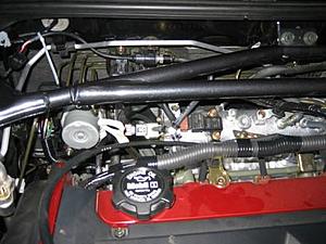

Let us know if it worked and also show us a pic of which line you tapped into to get rid of your problem. I have a similar problem, but with a mechanical gauge. Thanks.
here is a pic of what it will look like with the new instalation. don't have tools and camera where i'm at right now but someone sent me this picture of the conection you were looking for.
