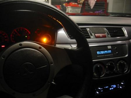

Here some quick pictures in the garage. Write up will have to wait.
Yes, it is only a LED that needs some sort of control box.....I use the Brockway R920.......any unit that allows for a light can use an LED.
Matt
Attached Thumbnails shift light-shift-light-001.jpg   shift light-shift-light-002.jpg   shift light-shift-light-004.jpg   shift light-shift-light-005.jpg

yeah it looks good but i was thinking about removing the lancer sign and the seat belt light and putting like 5 or 6 leds in there

That does look good... must be a B**** to install eh... I hope the write up is nice and easy to follow... Also, where can I find an AUDIO shift beeper (no light), or does yours beep as well as it lights up?
