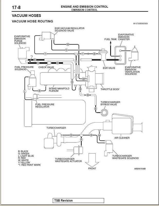

i'm putting my car back to stock before i trade it in, i was working on removing the MBC...but i want to make sure i get the lines correct, i was just assuming that the wastegate line runs to the blow off valve eliminating the T...but if someone can explain to me how it originaly goes i'd appreciate it. thanks

from westgate and turbo 2 to 1 , you have to get a "t" vacuum so you connect them together ,then from "t" single line will go to stock boost control.--this is first line from "B.C"
, the second will go to the intake .

Here is a diagram I found with a little searching.
