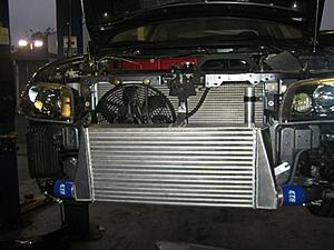

I have a cusco front power brace installed and I am planning my future modifications for the year. I have attached a picture of what the front power brace looks like installed. I am very interested in the ETS Intercooler but when you look at their picture it looks like fitment maybe a problem.
1) Is anyone running this combination? If so what thickness ETS option - 3"?
2) Anyone running this brace with another intercooler that confirms fitment?
Thanks for everyones help in advance.

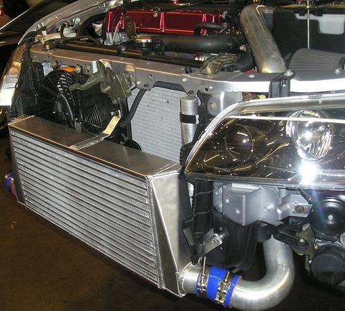

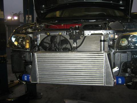

I found some more pictures while searching....
Think it will fit?

I think where it might not fit is with the short bars that connect the two lateral bars of the brace, and the corner of the ETS intercooler.

We've not fit one of our intercoolers here with the Cusco Power Brace but based on the pictures it appears that the bend location and angle is considerably more aggressive from the bar that runs along the top of the intercooler where it curves to where it meets the mounting locations. I don't think there's any chance of our standard width core fitting.
We'd be happy to build you a custom intercooler with 22" width and standard tanks (would make 1" more clearance on either side) or even 20" to make fitment even more certain so let me know if you're interested

Thanks for your reply. I sent you a PM but after looking at the pictures again and rereading your post I see your point. The width of the intercooler is not going to fit due to the bar. Would I loose potential HP by making the width smaller? And could you PM me the cost of a custom intercooler? Over the weekend I could take measurements for clearance so we would be certain which option to go with (22" vs 20"). But wouldnt the 22" definately fit if it is the same width as the stocker?

The stock intercooler core is 19" x 11.5" x 2.75". Based on that and the fact that our endtanks are of significantly less width at what would be the "point of contact" I do firmly believe that our intercooler with a 22" width will fit great! I'm replying to PMs right now
