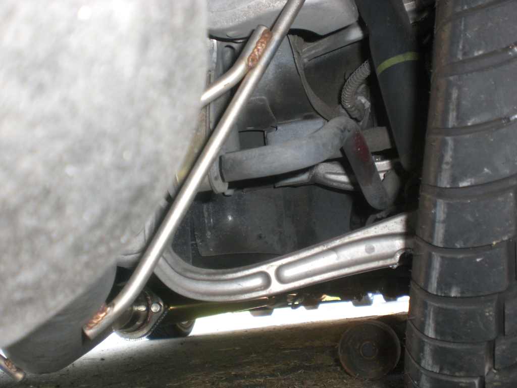

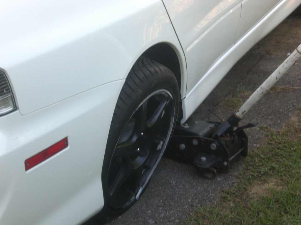

ok so like a month ago i was making a u -turn to damn fast on a wet road and the rear end of the car got away from me and i smacked a curb well needless to say i broke the rim bent the lower control arm and allsorts of other stuff ok well i have replaced all 4 control arm and when i let the car down off the jack the top of the wheel is bowed out and the bottom is tucked in any idea what else could be bent..thanks

Check the strut, and make sure you didnt bend any mounting points.

there is a small bend in the bottom of the strut do you think that could have sumtin to do with it?

Yes. A bent strut will cause the wheel to lean.

I think I can see a kink in the strut.

The rear strut does not have much of anything to do with the alignment of the rear wheel on the Evo. Did you check the hub, shaft, and bearing? Mounting points for the suspension arms and alignment? The rear strut does look damaged, so you should replace it, but it will not make your wheel do what your picture shows.

I know the strut wont have much to do with the lean, but it looks damaged so I brought it up. I would check the mounting points for sure

I can c a bend in the strut. also check the hub itself

1st thing replace that strut. It just a good idea in a situation like this. Look on the for sale section for sure, there are several part outs on there right now. Next look really closly at all the mounting point etc for the control arms. When you replaced them, did they come off and go on smooth, minimal forcing? I had a similar situation with my '91 talon, I replaced several pieces that I knew where damaged, and several I thought where damaged, all helped a little, but still didnt fix the problem. I ended up replacing the entire subframe and all the supsension componets..... Problem solved.

also don't forget to get a 4 wheel alignment and do a camber check as well.
