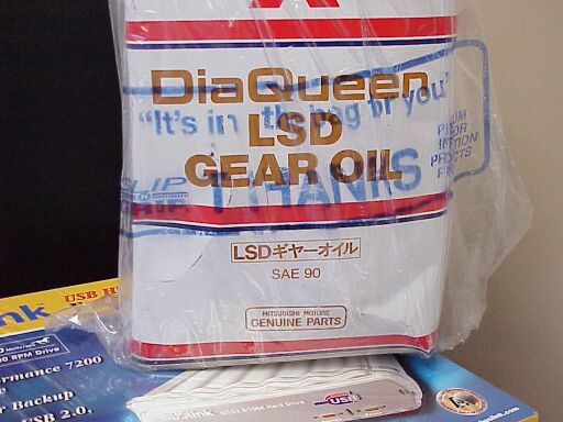

I just want to update everyone.
The rear *Hypoid Gear oil 81496030 EX or equivalent. .58qt I've ordered from mitsubishi came in today and it says LSD gear oil SAE90 on the can. SO the oil in the rear and the transfer case seems to be one in the same. Would someone please confirm this statement?
This oil should be GL-5 correct??

Old Aug 27, 2003 | 09:49 AM
iodine23's Avatar
Joined: Oct 2001
Posts: 776
From: Austin, TX
Well the oil in the transfer probably doesn't have the LSD additives that the one in the rear does. The rear diff needs lube with additives.
Chances are that stuff you got is GL-5, yes. There's a post here somewhere (I can't seem to find it now) that lists the weights and GL grades for the three fluids as outlined in the tech manual, not the owner's manual. It goes into more detail into what you want to look for.
