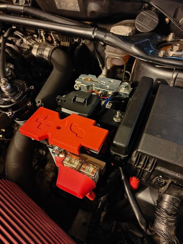

hmm definitely overkill. I've never had that issue with a small cheap battery and I ecuflash often. It works fine under 12v. do you still have the body ground for the intake manifold? I've added extra body grounds when its convenient
Now you wont set your ratchet down & catch my car on fire cleaned up the wires a bit too.
Yes I had all my factory grounds + mitsu's OEM accessory grounding kit.
Now I have a 1/0 ground from my alternator housing to chassis, replaced the factory intake manifold ground with a 1/0, 1/0 ground from my head to my chassis & replaced the factory negative terminal ground wire with a 1/0 & added a second chassis point ground before going to the block.
My starter, alternator & fuse box have a 1/0 power cable to match. Safe to say its a bit overkill but no issues & no regrets

cool. just needs a QC3.0 jk

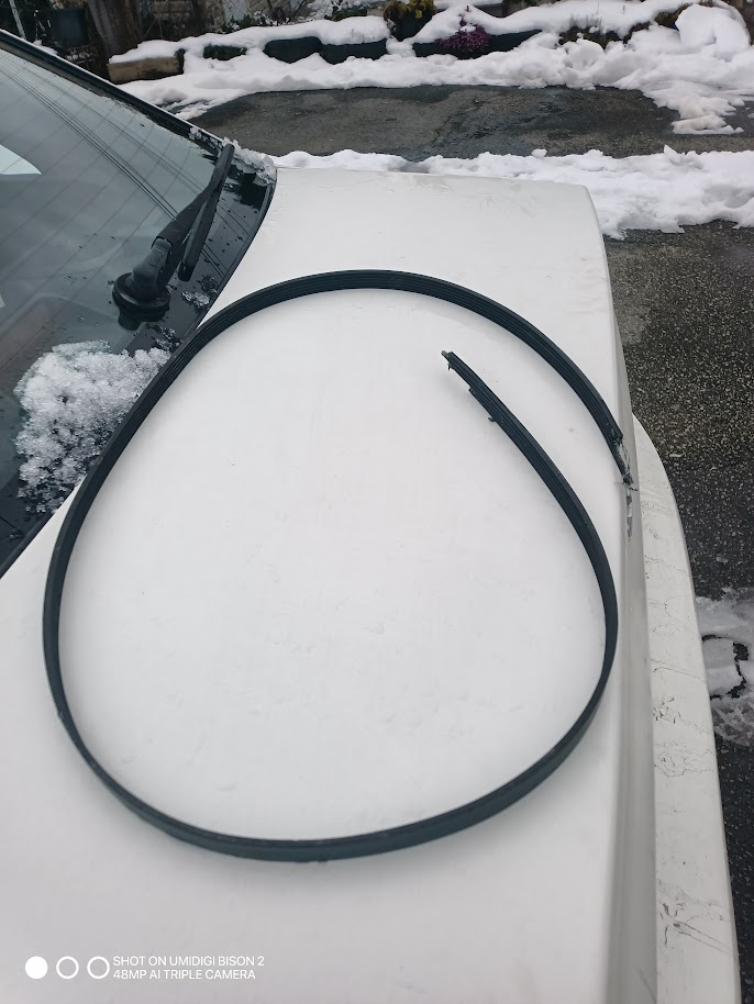

Went on a little road trip to help with a move...
...then this happened, luckily it's an easy fix so after...

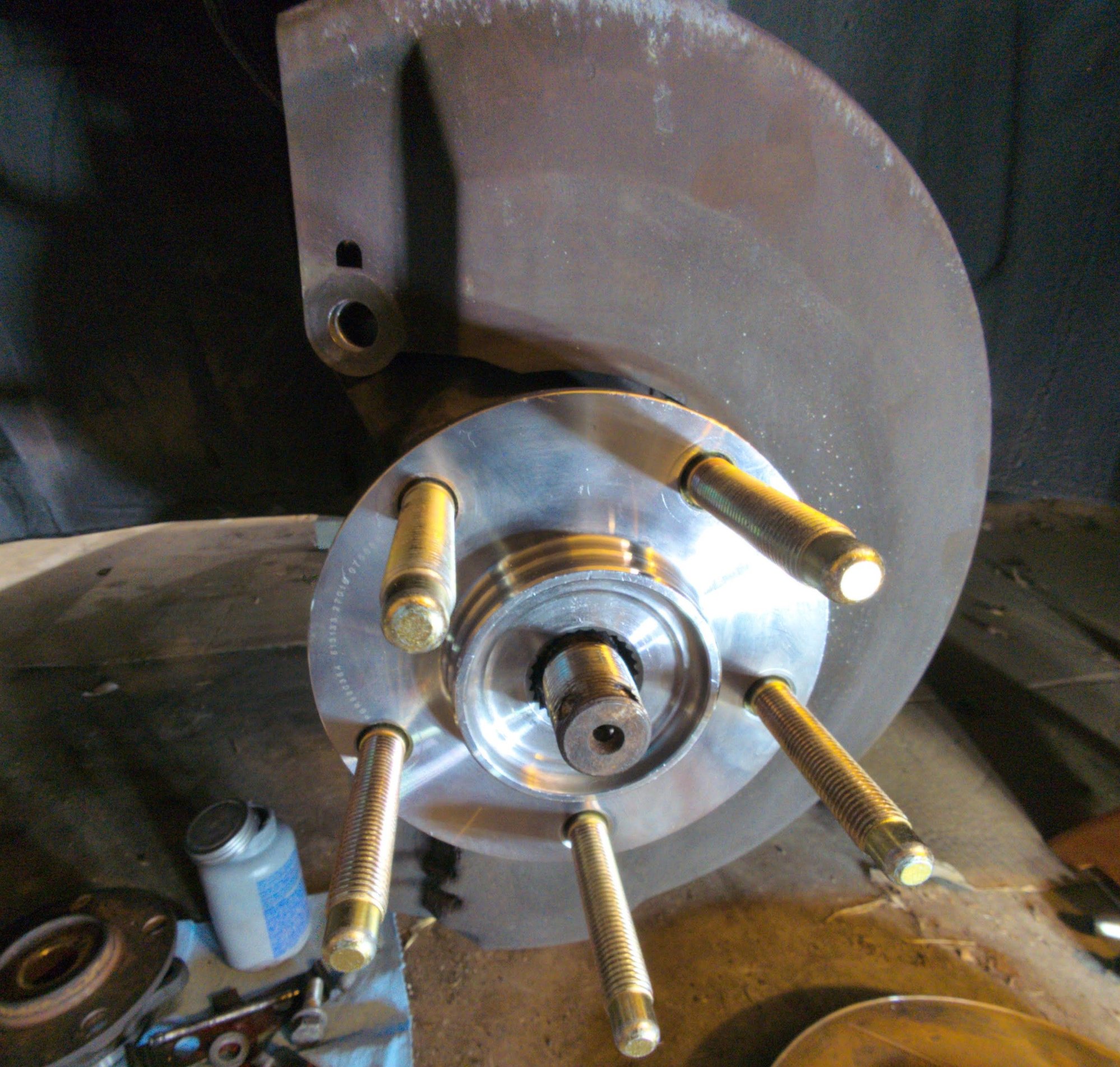

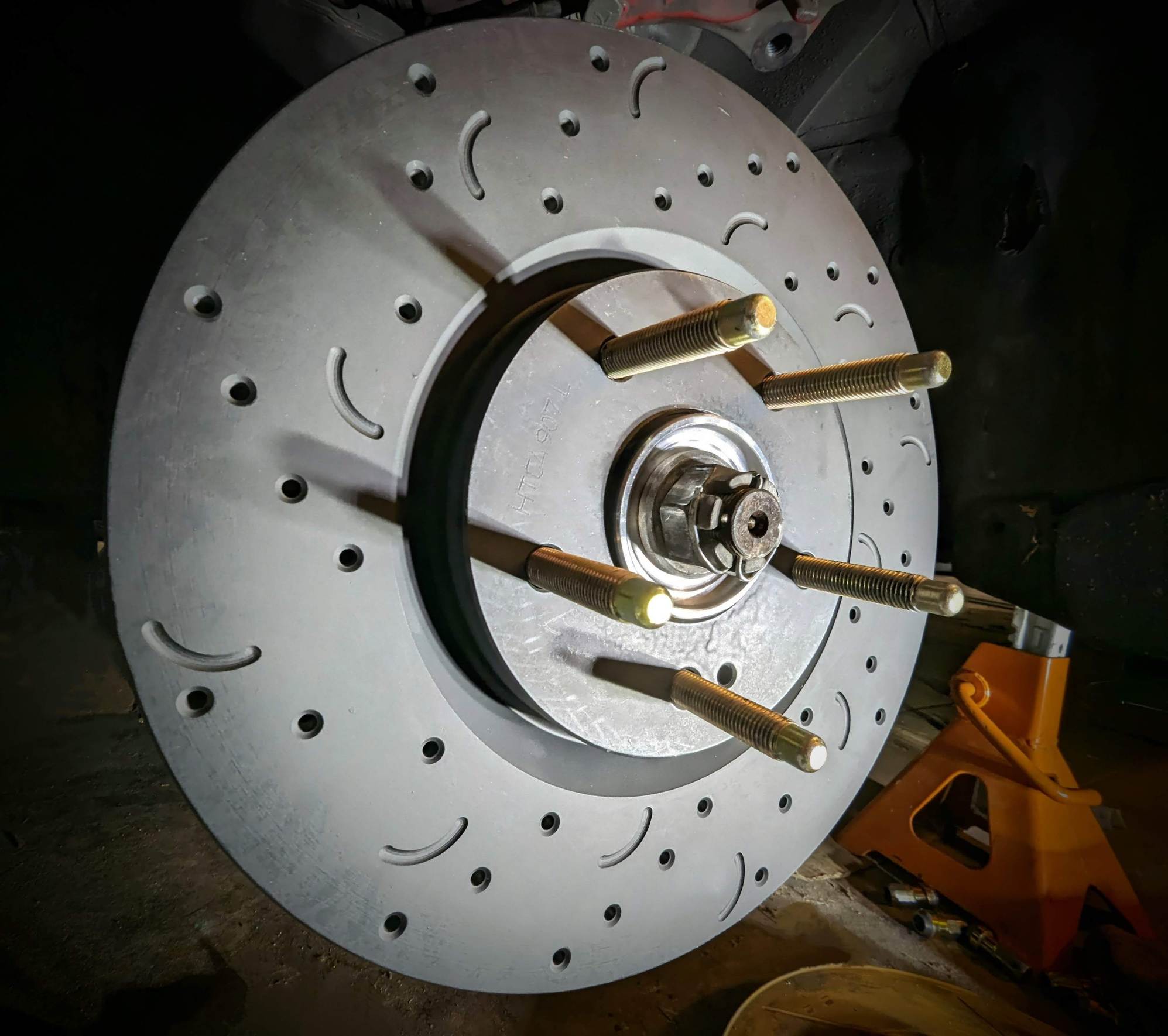

dNew wheel hub assembly, extended studs, brake rotors, tie rod ends, brake fluid.

Wow, how big of spacers are you planning on using? Those are some long studs. 😁

wide angle lens make them look super long, but they're standard length extends. =D . 10-12mm spacer nothing crazy. I track the car gives me piece of mind knowing my wheels wont rip off haha
