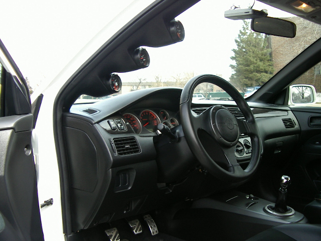

That is mis-information on the website. It fits over the stock pillar. You can heat up the plastic welds that are holding on the tweeter cover. Then you can attach it to the POD pillar with two part epoxy.
This is a picture of my install...

Originally Posted by shawn360h
cssaddictm4 did you have to trim anything off the pod to make it fit properly? Do you have a picture of the inside of your car so i can see how u mounted it?
I didn't have to trim anything at all. Unfortunately I do not have many good close ups of the actual pod. This is the best picture I could come up with for now.

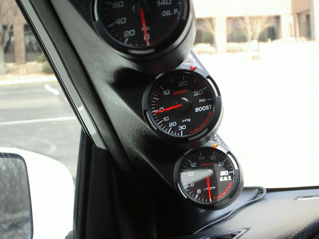

Originally Posted by chaotichoax
which a-pillar pod do you suggest?
The Autometer (which I have) seems to be the nicest.
Don't mind my radar detector power wire there; I've since tucked it in.
Although not visible in the pictures, it does have a tweeter cut-out.
Did you paint your pillars black yourself?
The Autometer pillar comes black so you can either paint it gray to match stock or do like I did and paint the passenger pillar black to match the Autometer. I personally like the look of black pillars much better.
