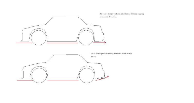

Its my understanding that a rear diffuser will simply straighten out the air and keep the car tracking strait and true whereas a wing will actually create downforce. Therefore they are two different pieces with different purposes.

A rear diffuser can infact create downforce as well as "straigtening" out the airflow from underneath the car and reducing turbulence.

A well designed diffuser will certainly increase downforce (or reduce lift if you want to be nit picky). I doubt that it is as effective as the wing. Unless you're on the track, you won't be able to take advantage of either.
And for the record, a spoiler, or wing doesn't magically "start to work" at a certain speed. It is working at all speeds, the force produced being proportional to the square of the velocity. So it is by far more effective at high speeds than low speeds, as others have noted.
