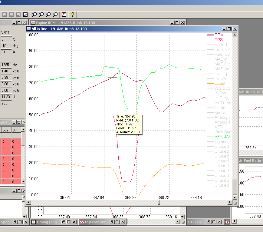

9sec9 - how are you defining shift times - by watching the revs and seeing where the clutch is obviously engaged, or by looking at the clutch switch?
Indy - how about some shifting tips for the gearbox-ically challenged?
Tom
tlcoll1, Since multiple events occur during a shift (off throttle, on throttle, out of gear x, into gear y), simply looking at a single event won't measure the drivers total shift time. I personally look at moving from 100% throttle (which drops engine loads immediately) as being the START time for the shift. The next is actually when 2 events occur. First is the throttle goes back to 100% and the second is when I see engine loads begin to climb again. Often the 100% throttle will occur, but the loads don't climb (clutch isn't released yet). Because of this, for a lift shift, I'm interested in highest load in the lower gear, then the loads moving back up with 100% throttle in the next higher gear as being the total shift time. It's up to me the tuner to get those loads as high as possible, as quickly as possible, provided the driver has done his job. I'm now seeing only 1 ecu read between shifts (off throttle % observed) and the loads are immediately back to where they were on the last read of the ecu at 100% throttle, just prior to the shift. It doesn't get much better than that for a lift shift. All of this is occuring with 0 knock on the shifts, unless the throttle is left at 100% during the shift and the load INCREASES momentarily at the end of the shift event. In that case, engine knock is extremely brief and self correcting by virtue of the rpm's dropping as well as loads.
As usual, I'm long winded, but that's just the way I am.

9sec9 - Thanks for the concise explanation. I think you're right on the mark. I was looking at some runs from my car last year at the track, and came to pretty much the same conclusion as to defining the shift.
Have a look at the 1-2 shift on one of my logs. I think the shift time begins right around the drop of TPS, but I'd correlate it with the change in RPM, where the RPMs stop increasing linearly and do the little bump-up, indicating clutch in. The clutch is then re-engaged a bit later, and there's a little oscillation as the clutch grabs. So I think if I had logged clutch in/out on this run, that would also be a good way to measure shift time.
Looking at my log, I'm around 1/2 second shift time. If Indy's really cranking out 0.2 second shifts, then that partly explains why he's such a beast at the track and I'm not! Maybe I need to swing up to Indiana for some driving lessons.
