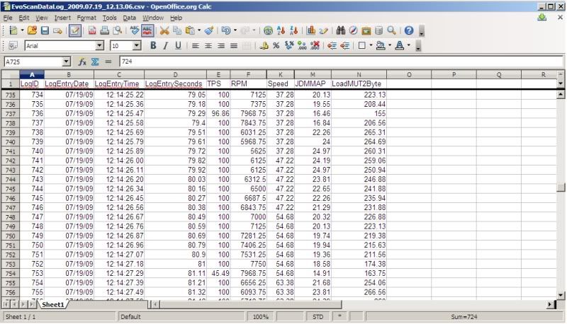

Tom, 9sec9 looked at the data and we made adjustments as we went. He tells me what numbers he wants to see and I do my best to hit them. This thing pulls all the way to the high 7000's.

Originally Posted by BerserkerX
I just want to say congrats again guys. I am just so impressed with all of this. Ha ha I wish I could spend some time with you 9sec9 to learn all that I can. I love to learn. That is why I like this thread. I know the 11 second pass is coming. Ha ha then I could spend some time with Indy and figure out how he shifts so damn fast!!
But with your tune though 9sec9 you were saying that you adjust the timing in low load high rpms. Do you mean that since you shift at 7500 and say load hits 240 there. Do you go to lower load in the 7500 column and adjust that? Or do you adjust it for where your rpm and load hits after the shift. Say it goes down to 5700 and 260 load. Do you make that the same timing to where that at 5700 and 260 you hit the same timing. Sorry for the silly question just trying to clarify.
Excited to hear how the tires do. I love the car and how well its doing.
This is the exact map we use on Indy's car at the track. The timing is set in certain places for specific events in the run. A good example would be 14 at 7250 and 200. Anyway, this is the same map we use/used for the 12.0 runs. Each trip to the track varies just a bit based on baro/temp etc. We monitor every run very closely so it's never too far from our 'center'. Hope this helps you understand what I was saying.
Although the above map is slightly more current, the previously posted 'shift' logs show what happens during and after the shifts. Notice the above '8's in the high rpm low loads and WHERE the timing needs to be at about 5500/260. Voila, no knock and timing is there, '8' degrees. That remained true as long as Indy shifted slow and we got into vacuum between shifts. As the shifting got faster, I had to lower the timing at higher loads to meet our target of where I wanted the timing AFTER the shift was complete. It really gets interesting when RPM goes UP during the shift and the ECU sees HIGHER loads than BEFORE the shift. I adjusted that some too. I said I would post the map, and there it is.

Here's a different run showing a shift where the timing only moves a few degrees from max rpm and the next gear at lower rpm and higher loads. I like to keep the maps as smooth as possible without the peaks and valleys you sometimes see in a tune that's been 'hurried' through. Sometimes a change in one area requires a complete remake of the 'blending'.
