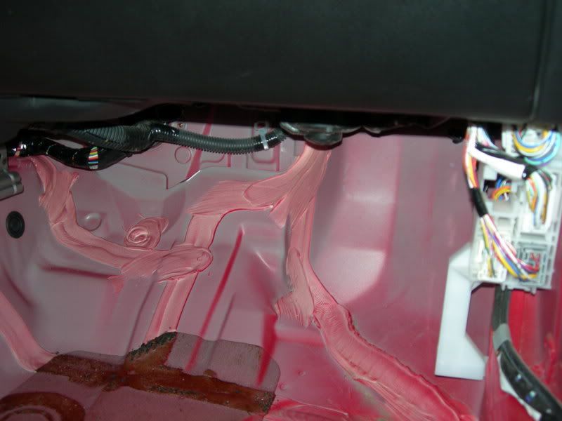

RS only has the two little tar pads in the footwells. If you want some photographic evidence:
Passenger footwell:
Driver footwell:
Back seat area:
I didn't remove any sound deadening, mainly because there really isn't much to remove, just those two little pads.

i had a 06 IX RS and this is how it looked like when we removed the floor carpit
just a bare metal - nothing.
