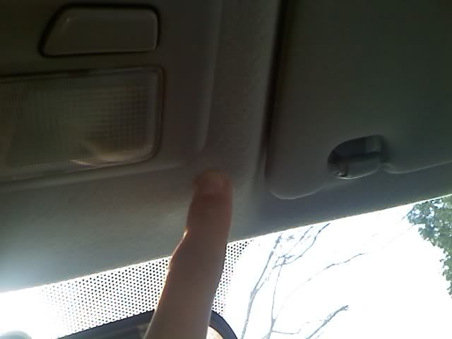

Well it poured two days ago. I went to my car for school and noticed that where was a leak coming from the door lights (In the middle of the two front seats.) Water drips from on the right side of the passenger light. My passenger seat was wet and it started to smell like gym socks. Anyone know any ideas why it would be leaking? Ill take a pic since my description isent the best. Also im going to take out the lights to see if i can find a reason. The only idea i have is that water is leaking from the vortex Gen on the roof.

here is the pic where it leaks
and maybe it could be the vortex? Dont know if the spacing is to much or it is just normal?

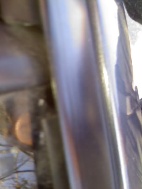

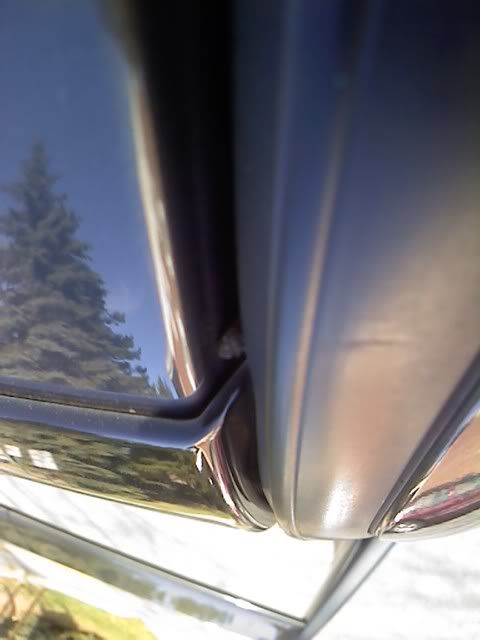

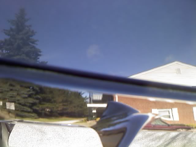

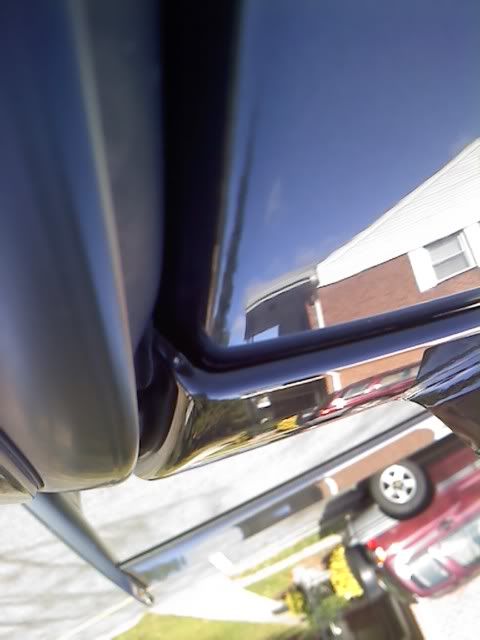

I found where the leak is coming from. The pic is kinda hard to see but under the Weather strip is a hole were the glass ends. It is on both sides but the driver side is the biggest. Anyone know a good way to plug it up?
Old Nov 22, 2010 | 12:00 PM
wazzelby's Avatar
Joined: Jul 2007
Posts: 342
From: Colorado
If you can get some silicone in there then you're set. Shouldn't take too much to seal it up.
