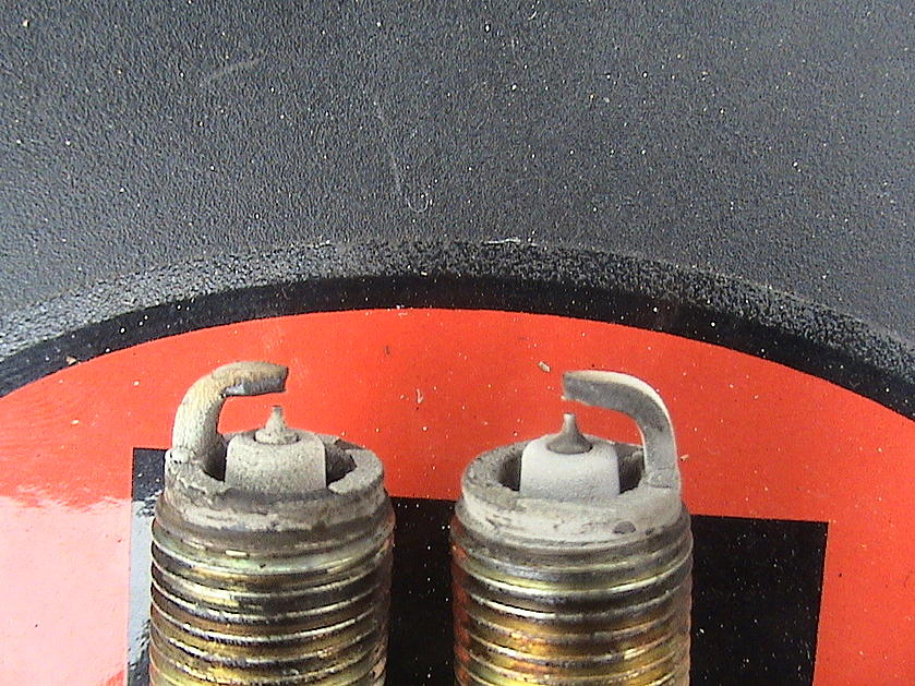

Could the plug on the left be causing occasional hesitation? Other two look like the one on the right. 45,000 on them. Read These Plugs-uicp-002.jpg

From what I can see on my cell phone the plug on the left is not in good shape that could be a cause if its not firing right
Exactly right man..Looks like he might have ignition issue..

Ya, the 1 on the left is done! Get some fresh plugs in there.
